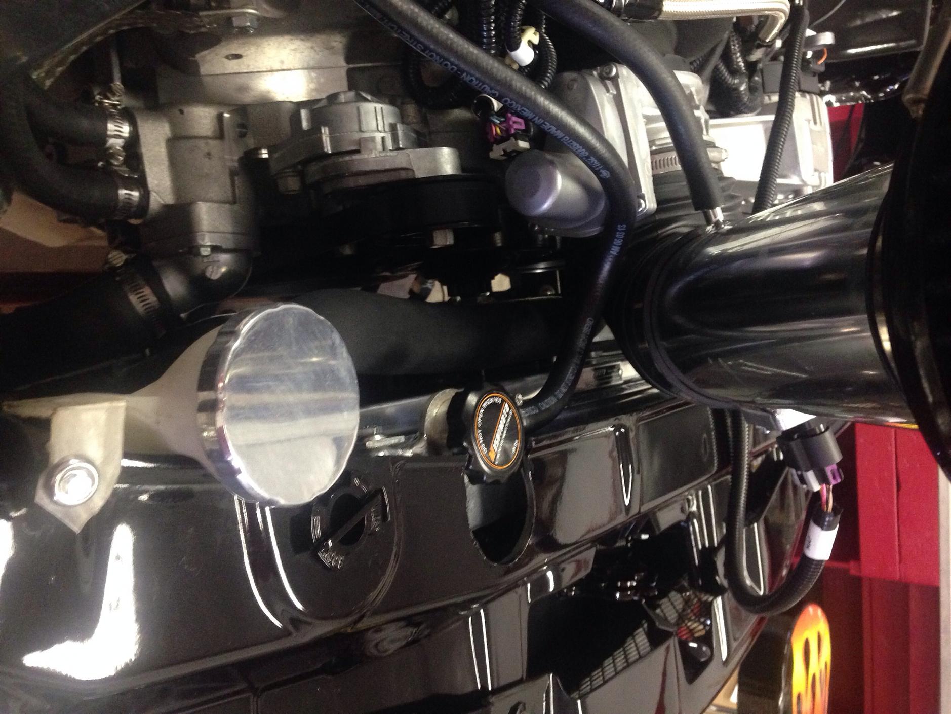

Stu and Hybrid, what are you guys using for radiator/fans? OEM?
I'm planning on running AC and I heard that the temps will go too high if so, with the OEM rad.
Thanks

Mishimoto dual core and dual fans.

Can you post or pm me a pic of the clearance?
Thanks!
Old Dec 1, 2013 | 12:36 PM
  #117
stusg35's Avatar
Posts: 179
Likes: 13
From: Kenosha, WI
Fan and radiator clearance
Here's the clearance I dealt with

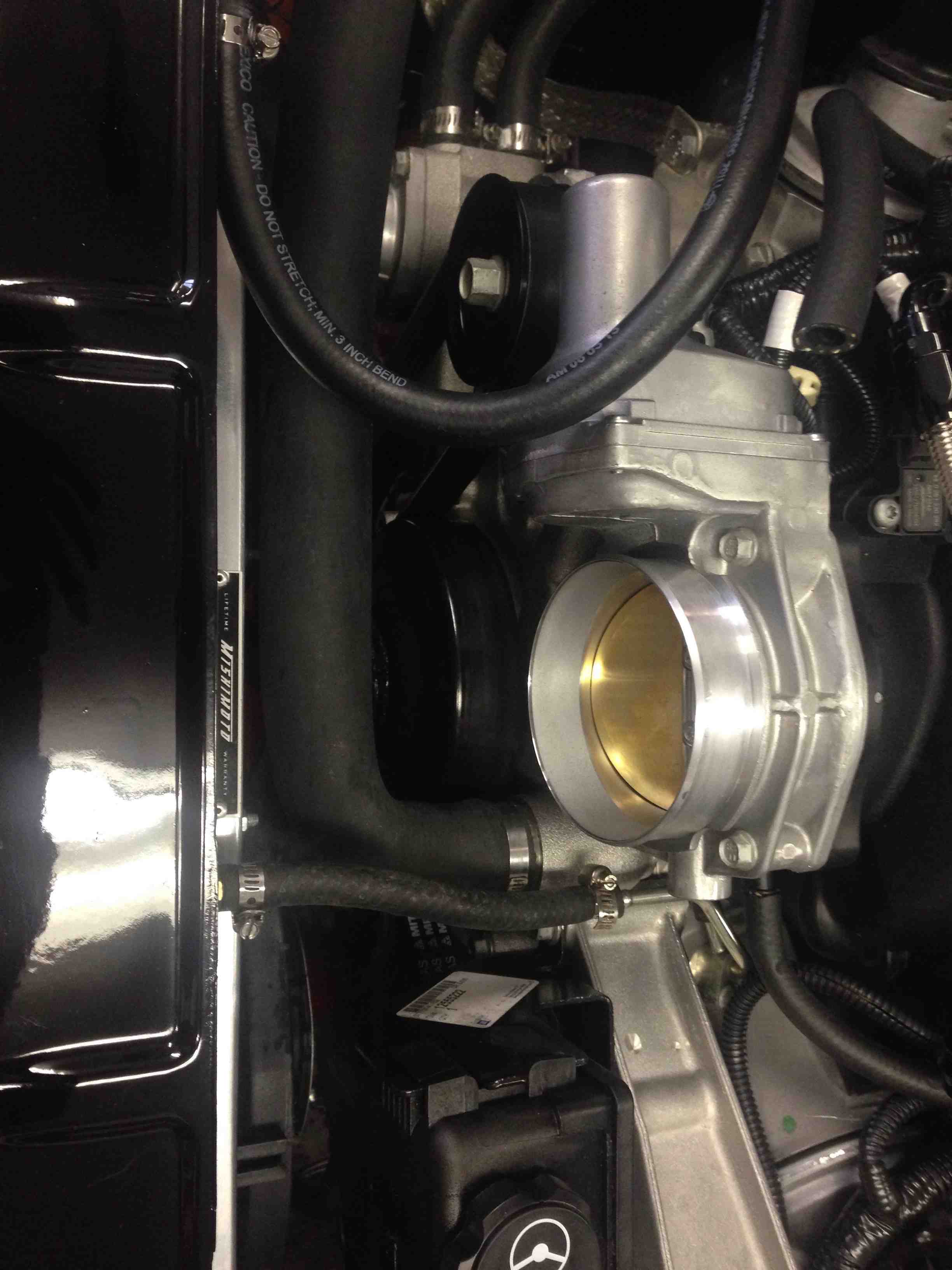

From: Kenosha, WI
Heres another pic

Originally Posted by stusg35
Heres another pic
Thanks. Your radiator hose looks molded. Where did you get it? Did you replace your fans as well?

^ I was wondering the same exact things.
