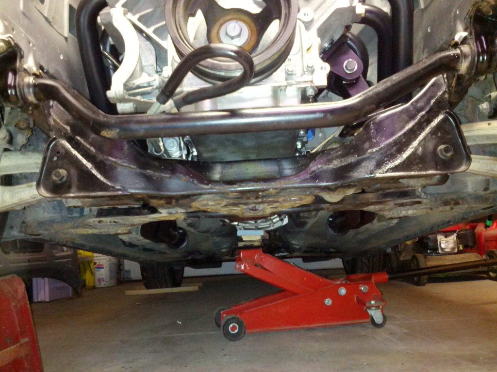

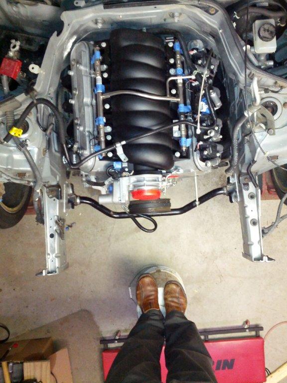

OK a pic from directly above and one from below as promised.

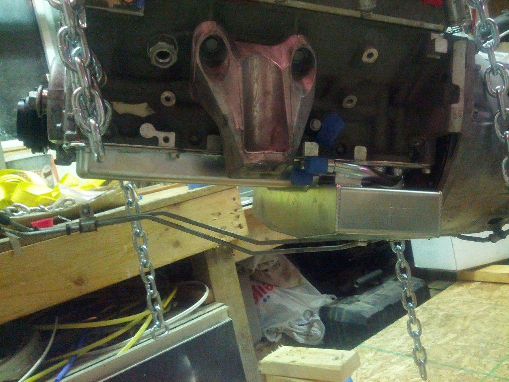

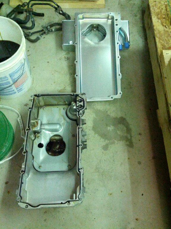

Here are some better pics of the oil pan.....Very shallow under the front of the pan, the sump where the Pickup tube pulls from is at the back.

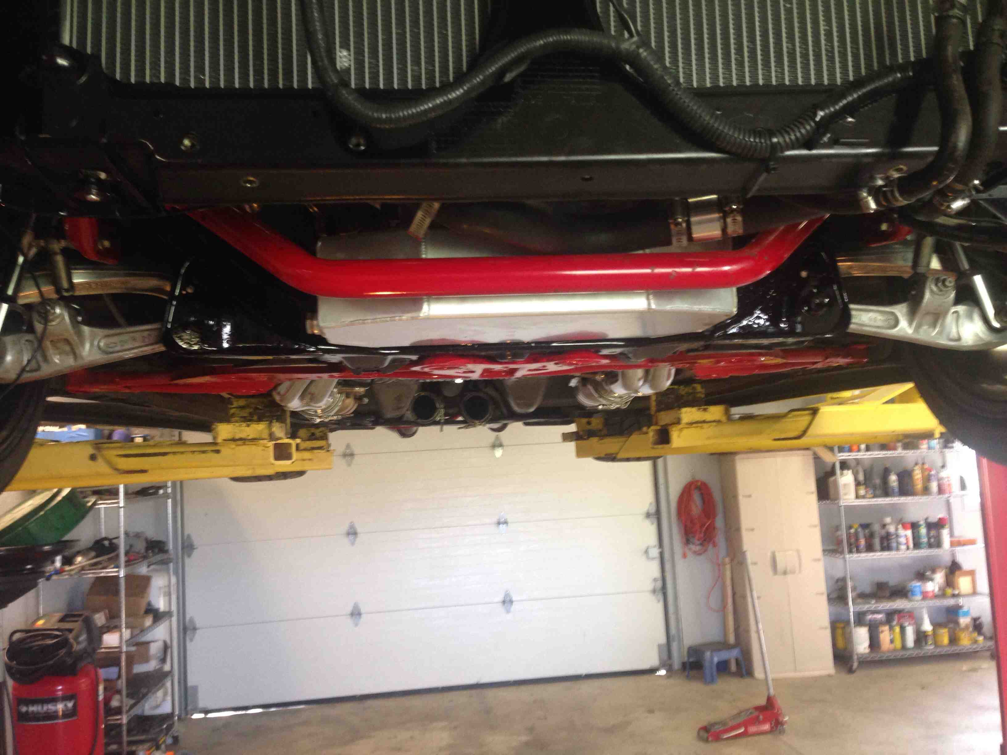

Heres another shot of mine buttoned up. Underneath you can see the clearance is great with the sikky kit for my oil pan.
Im driving tomorrow. It will be loud due to the long tube headers and high flow cats only. But I gotta take it out beforte winter kicks in in WI.

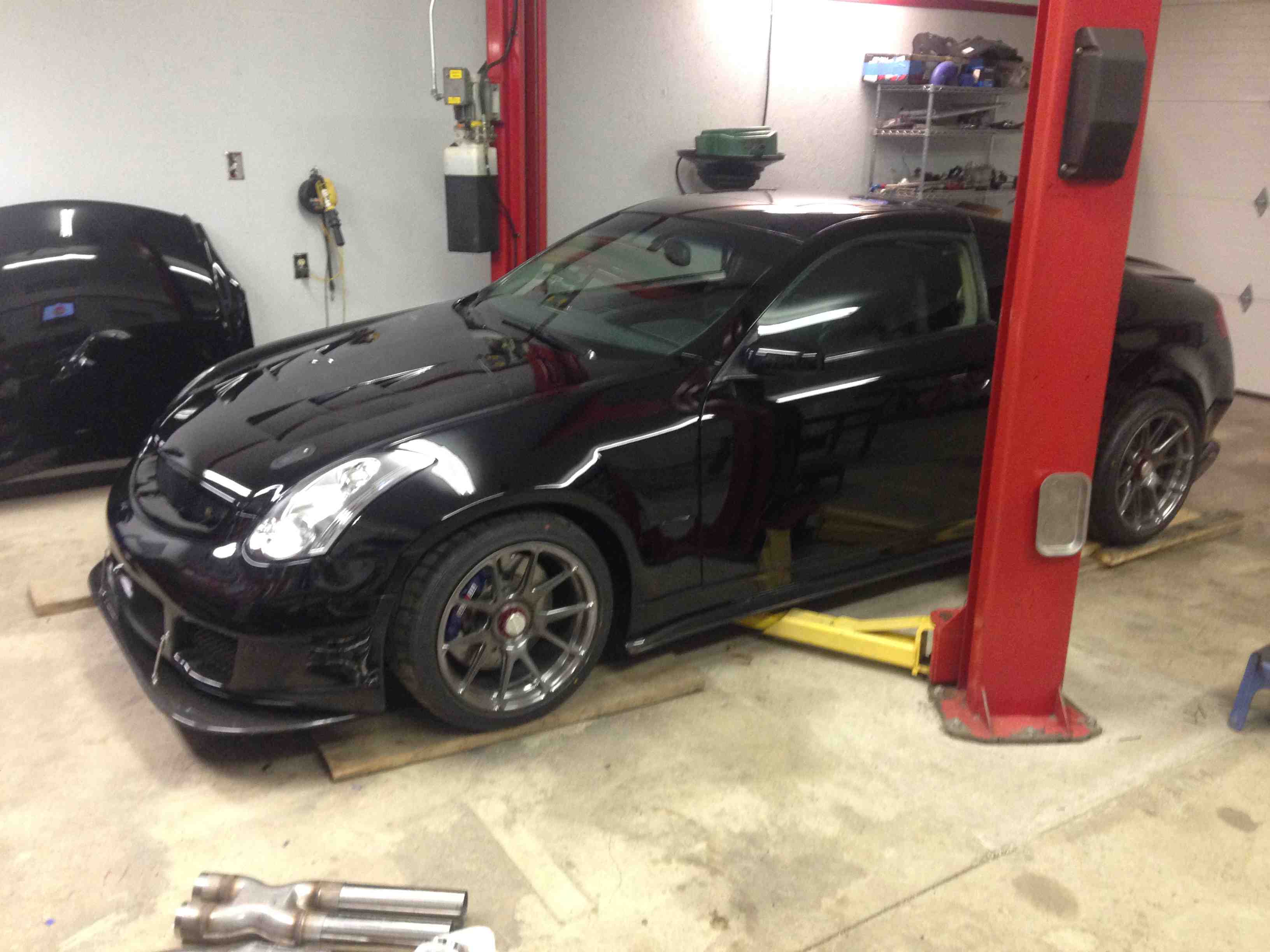

Mines done. Runs awesome. Sounds amazing. PM me if you have anymore questions. Heres a pic down by the lake today while I was out breaking in the motor and trans.
