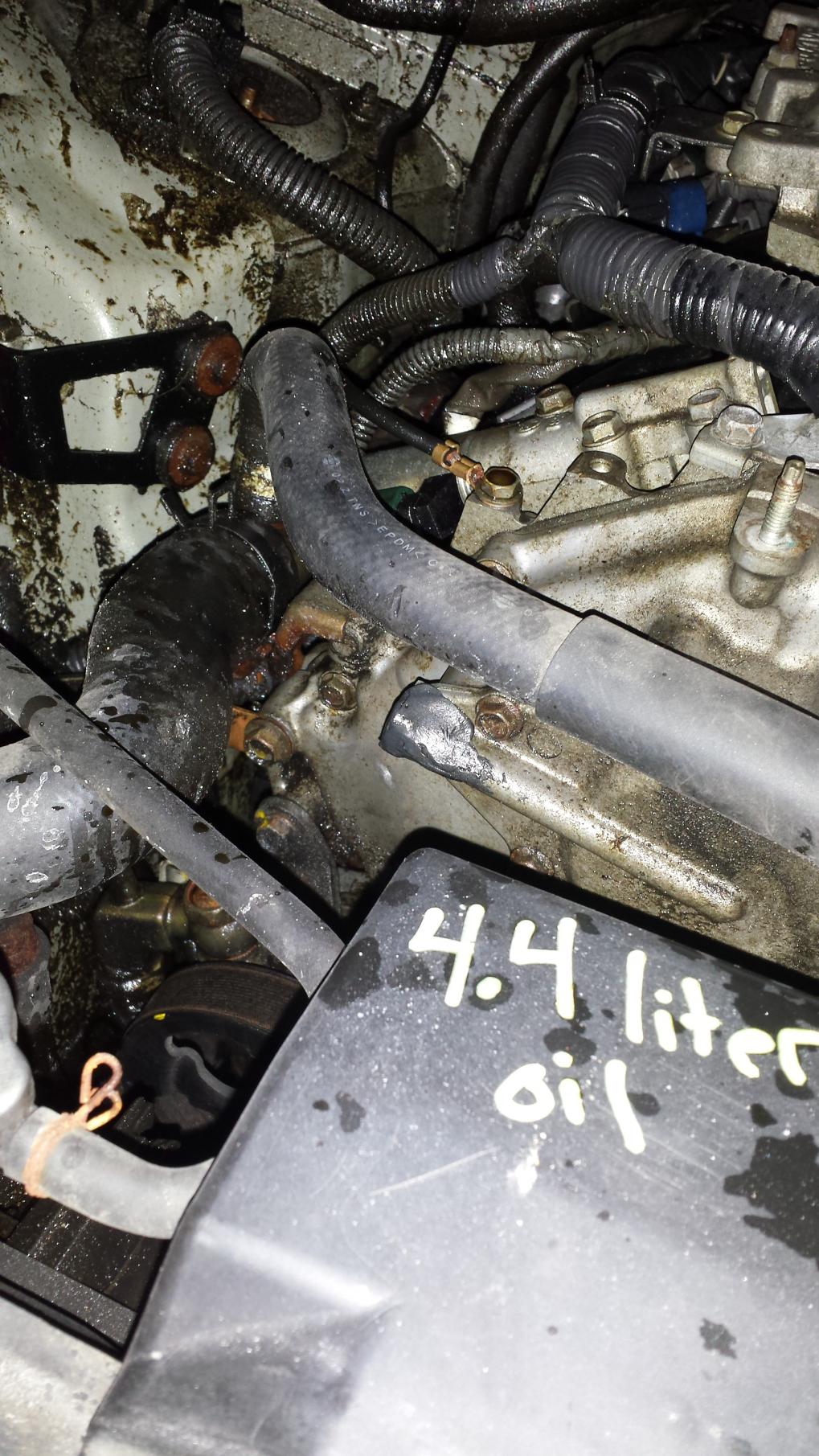

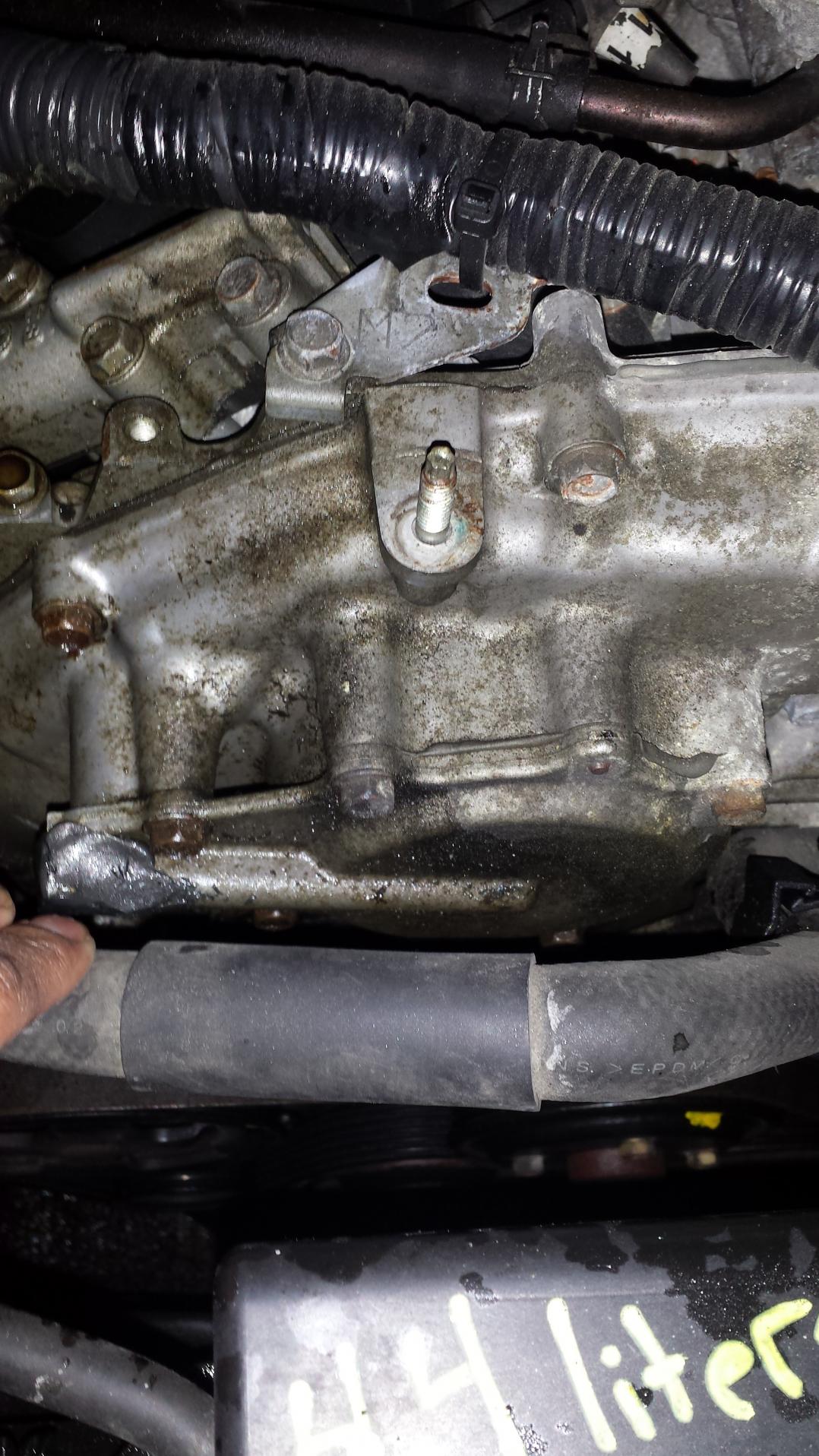

Now I have fixed everything except the oil leak. Attached is a picture of the location of the leak. It seems the previous owner attempted to fix the problem with some Defcon but oil is still blowing everywhere in the engine bay. I am not sure if i risk damaging other parts with so much oil everywhere but nonethless it nneeds taken care of. Here are pics of the leak. circled is the area where the oil is leaking.
CAN ANYONE IDENTIFY THIS PART SO I CAN START WITH REPLACING IT ?

Ps its the part where the putty looking stuff is. Defcon

Am I looking at the timing cover? Is it cracked?

I don't see a circled area. But where I see the puddie applied is the timing chain cover & to properly repair it would be to replace the whole cover.
+1
That's what I'm seeing

Thanks guys! Looks like im going to need to look for a timing chain cover.
Yes the leak is coming from the puttied area. how the heck could have that happened in the first place?

Now that I look closer I can clearly see a crack from the puddie'd area to the bolt below it. I know from a (bad) personal experience they can easily be cracked. perhaps the previous owner took the cover off to replace the timing chain guides, water pump, etc . Created a hairline crack from trying to yank it off when not all the bolts were out which grew over time,over tightened the bolts, blunt force... who knows.

So the timing chain cover needs to be replaced? does anyone know the part number? the timing chain cover will cause oil leak i suppose? will it cause the car to run rough? as if the oil pressure is being affected? Is this an expensive job? is it possibly a task i can do myself?

If it's where the putty is that part is the variable valve timing cover if I remember. Those are held in by RTV/bolts and you can replace them separately I believe. If your whole cover is cracked then I think that's like 300 bucks. You'd need to drop the lower oil pan also to take it off. I did my water pump, chain, and tensioner not something I would want to do again!
