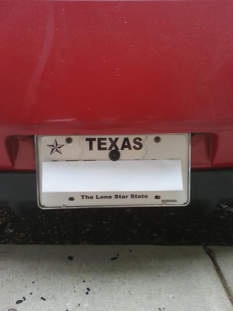

I bought the smallest camera I could find online and drilled a hole through my license plate and used a firewall grommet to hold it in place since I hate how the license plate frame ones looked. As for the wiring it was really simple, I forgot how I wired it tho lol but it's posted somewhere on this forum I'll look for it and link it in a bit. Oh and I have the pioneer avh 4000.

^^ just read up on this thread its the one I used and asked for help on to wire up my reverse camera. What confused me was connecting the yellow camera wire , I thought it was yellow to yellow but it was actually yellow to the brown input in the back of the double din.

JG that looks really clean, I've seen some systems on eBay where it's a bar that's already connected to to the camera all there is to do is mount the bar into lisence plate.

I had/have one of those. They work, and only cost a few bucks, issue is video quality is badddddd. It will get the job done though lol.

Thanks man. Yeah I honestly hate how those license plate frames look. I wanted a more stealth kinda camera, so I just hacked up my plate lol.
