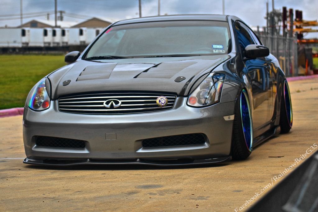

Now, quite some time ago, I was all about projectors headlights. The price kind of scared me, but, like everything I wanted on this car, I just figured I'd save up and get them. Then, I saw these....'
They didn't quite look like this when I met Junichi (the red car is the newest version), a few years ago. But, I'm in love with what he's done with them. rainbowbrite35 (or nurse35....aka Chris) is a (no longer active) member on here who also opted to stay with the factory 03-05 non-projector headlights. His also look amazing.
So, if you CAN keep them and polish them up, there's definitely life here. And, it may be the only option if you don't hop on a pair soon.

Originally Posted by driftsucky
replacing them may be a bit more difficult if you want to go to projector headlights. Yeah, they're in the $700 range and they're going up because they're becoming more and more scarce.
Thanks so much..
So is it possible to fully resurrect these lights to that quality?

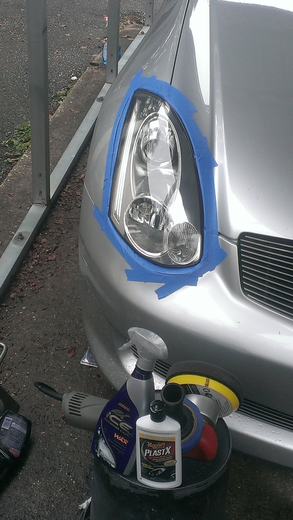

OP, check out this thread. I've sub'do for long term updates on the sealant. Mine look pretty good until the lights are on and then see a bit of haze. I'll be doing this within the next couple of weeks. After you polish them sealing is key.
https://g35driver.com/forums/lighting/442845-polish-seal-g35-headlights-tail-lights-opti-lens.html

The best headlight restore kit is made by 3M which includes everything you'll need to bring them back to as new condition or you could find a shop in your area that restores headlights. Average cost in SoCal is right at $99= so you have choices. Replacing your headlights would cost you far more, but not a bad idea if you upgrade to '06+ projectors...Gary

Look here OP, I used this thread when I chose to wetsand my headlights. https://g35driver.com/forums/care-de...at-anyone.html
I chose to use a 3m rubbing compound and turtle wax polishing compound. And they came out perfect.

or compound and a polisher, seal it with wax and it comes out great.

Wetsanding and polishing can restore your headlights. Apply some sort of clearcoat to bring back its natural protection from UV rays.
