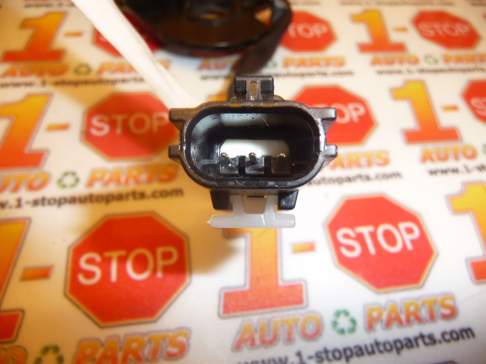

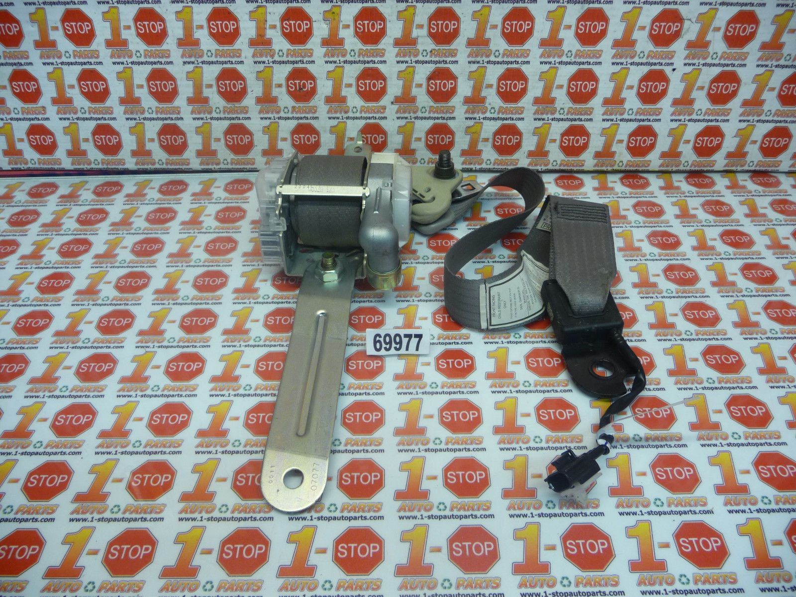

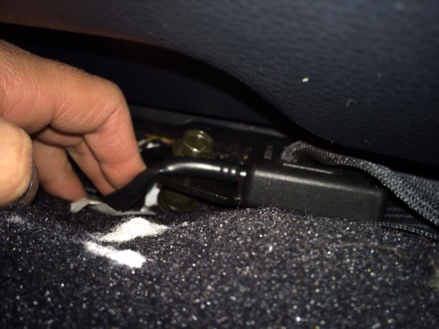

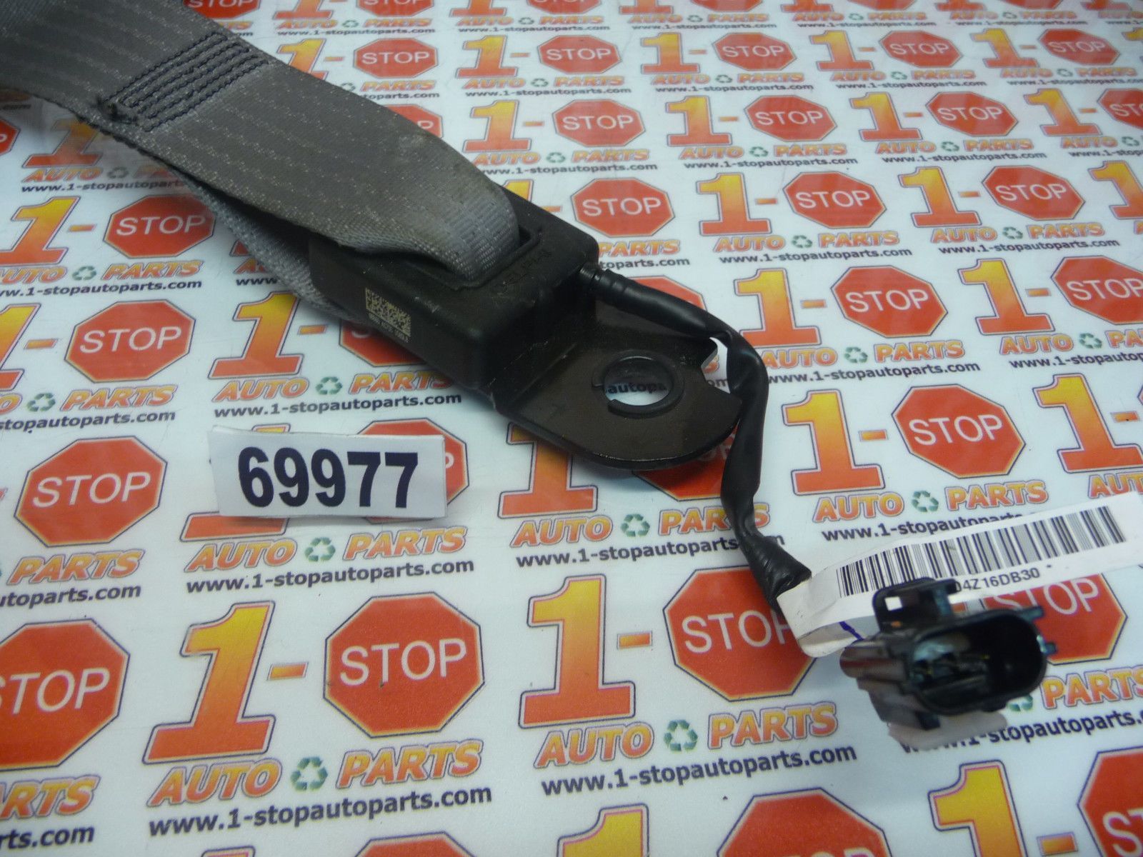

for the passenger side though where the anchor is attached to the bottom of the door next to the seat, there is a sensor coming off the end. this sensor is not on my 350z seatbelt so i dont know what im supposed to do. does anyone know if the actual sensor can be detached from teh seatbelt and swapped to the new one or if i can just unplug it without throwing a code?
i am looking through ebay at g35 seatbelt retractors and none of them have this sensor... idk if its a new thing that came about in the 06 or what but im not sure what i should do.

Logic tells me that the sensor can be related to the Safety Restraint System (SRS)/ Air Bag System, but I do not know for sure sorry man.
I did read the following in my Service Manual and thought I should share it with you, I hope it helps you make the right decision. Don't sacrifice or compromise your safety or that of your passengers for looks. Not preaching, just saying.
