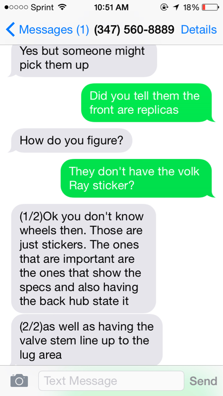

So are you saying they're legit or fake lol, a bit confused. Seller sent me more pics, it has allt he rays stickers inside and Rays eng in the back hub ring. they are 2005 wheels

I believe they are genuine after receiving more pictures, might just go pick them up right now. Got a good deal on em as well

They're not replicas, I have a full set of 18s from my S15 and they have all the stamps on the inside and weigh next to nothing, but have no embossed text around the outer rim.

yeah they seem to have the stickers but no stickers on the spokes or stampings.
this is the most common replica wheel out there. I wouldn't pay 2700 due to horrible widths and odd diameters.
