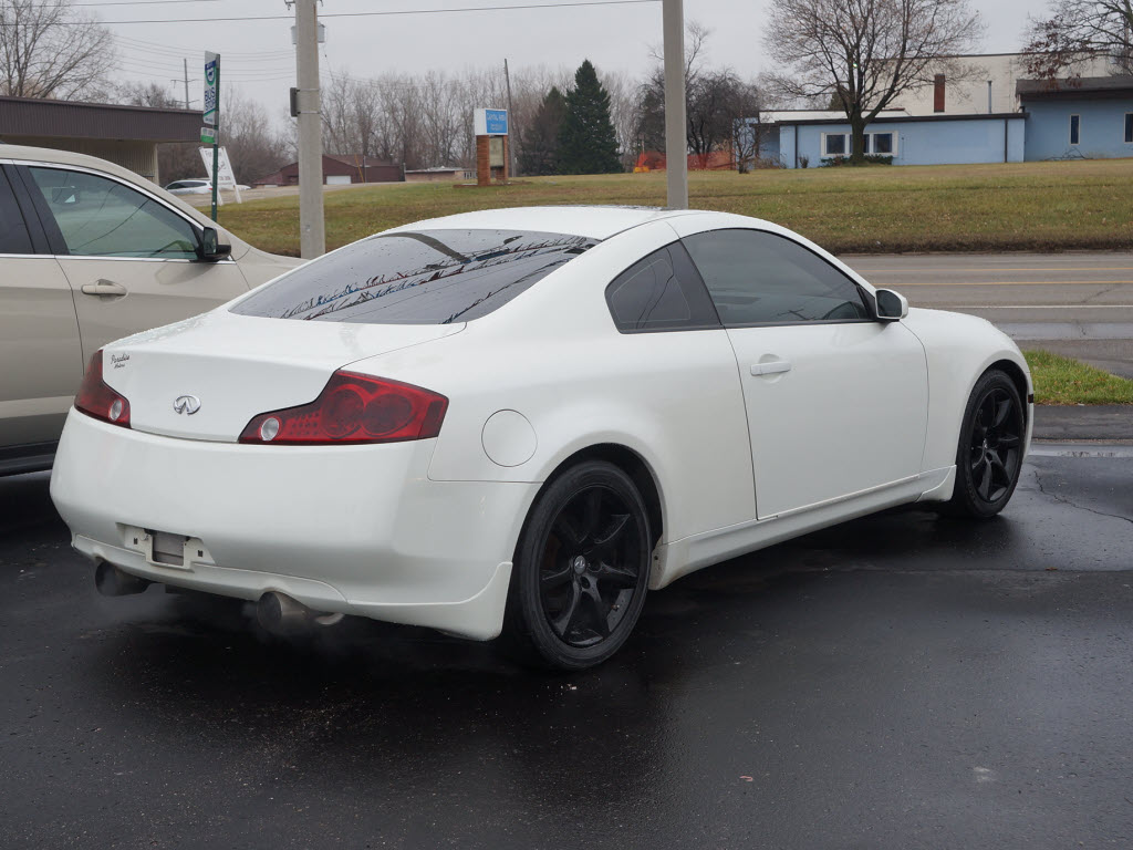

Thanks for the reply's! I will get working on the bearing within the next few days! I can't say anything bad about the car!

Nice look'in Ivory Pearl (IP) coupe! You can begin by removing the dealership add on your trunk lid. Did they give you a major discount for advertising for them? Search debadge on how to remove it without damaging the paint...Gary
Old May 7, 2015 | 01:30 PM
seavolt88's Avatar
Joined: May 2015
Posts: 5
HA! I'm taking that crap logo off today lmao funny you said that Gary! 😃
