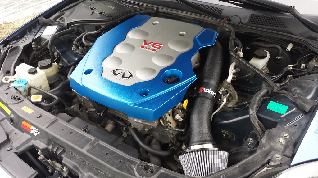

Just installed my Takeda Retain intake and wow what a power gain
so I finally decided to step up and grab a intake. I was doing some research and I have came across a lot of good options but I ended up going with the Takeda Retain short ram intake. all I can say is wow. they claim 19 hp and let me tell u what I can most def feel it. This mod along with my shift kit in the tranny has really woken a beast inside of my car lol just thought ide throw this up so you guys could see. BEFORE Name:  20150520_181837_zpsr3sddeel.jpg
Size:  229.7 KB AFTER Name:  20150521_180902_zpst0xsme56.jpg

I really hope you dont think you gain 20 hp with an intake.

Lollll no heat shield ahahahhaahha

Size:  36.1 KB and that is the pic they give u with the intake. there is no heat shield option.

Yea right speed, this sounds like all the adds from 10 years ago claiming hp/torque gains from intakes. Claims might be true with some cars that are poorly engineered just not our Infiniti G35s! And then there's the exposed filter and anodized tubing which will cause major hp loss once it gets hot! Nothing worse that getting left at the stoplight by a '80s VW bus!

Sound like a marketing guy...
Exposed air filter in engine bay plus aluminum tubing?
OEM intake is well designed. Z-tube plus drop in K&N is all you need. Add in a motordyne intake spacer to address the starvation of the two front cylinders and there is really not much else you can do to the intake system of these cars. It was well designed from the factory to begin with.
Only way infiniti was able to improve on it was the dual throttlebody setup on the 3.7L.

You have to be either new to cars or trolling.
1. That 'dyno' from the manufacturer is completely fake. Pretty much every company (except for motordyne) uses fake dynos. A dyno is extremely easy to manipulate by changing correction factors, using big fans, temps, etc. I can easily dyno a car before and after with 20hp gain without changing a single part on the car.
2. All short rams are the same exactly the same. Some have heat shield like JWT, but will eventually heat soak as well. The only real difference between short ram intakes is looks. They give almost zero gain without piggyback or retune. Most you'll see is 5hp which is negligible and can't be felt.
3. All cars are different. Even if they did post a real dyno, it wouldn't really matter. You car won have exact same results. Only way to know is if you do before and after dynos yourself.
