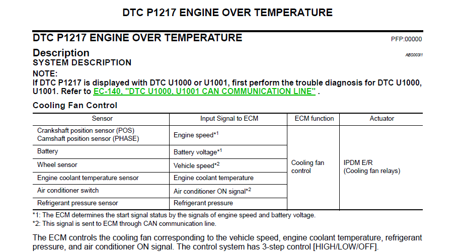

Here are the attachments, left them out of the previous post.
Attached Thumbnails G35 Coupe Overheating?-capture.png   G35 Coupe Overheating?-capture-1.png

You get no air cooling at all on a water-cooled bike or any water-cooled motor for that matter. The material on the heads on a water cooled engine are far too thick to provide any sort of air cooling directly to the head and the head internals are also encased in a water jacket that pretty much insulates it from exterior air by even more material. An air cooled motor has (by design) a much thinner head construction with large cooling fins extending out from each head to increase the surface area for cooling purposes and heat radiation. This is why air cooled motors are generally louder than water cooled... less material in and around head to absorb and dampen the combustion noise within. And I'll repeat it again in case you missed it the first few times... the engines on basically all sport bikes are NOT out in the open. They are nestled into the frame beneath a fuel tank and mostly covered on both sides by a fairing and blocked in the front by a radiator. All of your cooling comes from either purely water cooling or some combination of water and oil cooling through radiators. I currently own and do all my own maintenance and work on 3 motorcycles and have had many others over the course of my life..... I doubt based on your clueless comments that you own any or have any experience with maintaining or repairing them at all.
Please stop posting bull$hit that has clearly been proven to be wrong by the factory provided service information:
Originally Posted by andrewvk
im confident in telling you. you need your ****ing fans on and moving, even at highway speeds
lol ok well you can think what you want. but your fans not moving while at speed will block more air than they let through. they are running while at highway speeds i can assure you.
your fans will and need to run at any speed you are going. i dont know where scraggle heard that info but thats super false.
bottom line, if you think you can shut your fans off because you are on the highway. you are wrong. sure you might be able to do it, but your cars cooling system will not run as efficiently with the fans not pulling air through the radiator.
