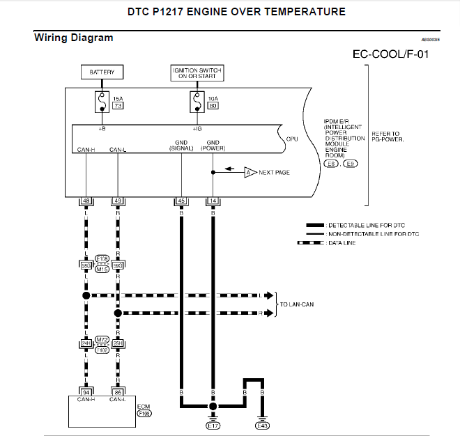

You can check your fans by applying power and ground directly to the fans. You would need a couple of test leads to do this. Both motors have a 4 pin connector. Pins 1 and 2 are the power pins and 3 and 4 are the ground pins. Pins 1 - 4 and 2 - 3 work together to complete the circuit and make the motor run. For example, apply 12V to pin 1 and ground to pin 4 and the motor should turn.
The reason for the two pin combinations is because one circuit is activated when the A/C is turned on and the other when the engine reaches the temperature requiring cooling. By doing this check you isolate the the fans. If the fans turn, then you have to troubleshoot further. There are different ways to troubleshoot, it all depends on the person's approach to the problem. Do you own a Volt/Ohm meter and do you know how to use it?
Attached Thumbnails G35 Coupe Overheating?-capture-1.png   G35 Coupe Overheating?-capture.png
Thanks for the diagram and info Wuzz-upp.
Will definitely look into that and report it back to you guys.
