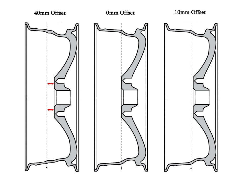

5x100 is the wrong bolt pattern.
You need to get wheels that are 5x114.3 bolt pattern, and as for +40 that just means the offest heres an image. Offset adds lengths to the wheels which make them stick out some. To match oem spec you need +30 offset (assuming you have 18" 7 spoke) hope this helps.
From one chris to another

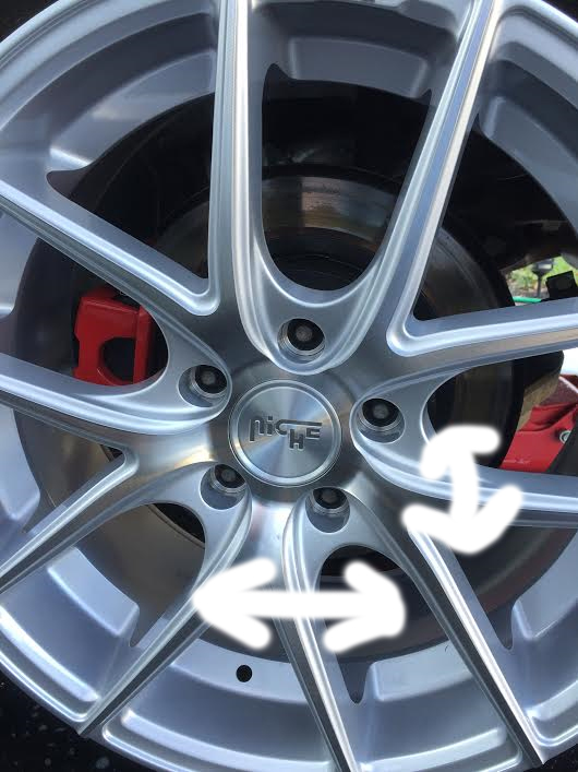

Thank you guys! I appreciate all of your responses, its been a big help! I received the rims today and "dry fitted" them.
I noticed some play in the rim once on the lug studs When I put the OEM rim the lug studs allow zero movement of the rim.
When I put these rims on... Niche M131, part number M131188065+40 I notice a little play. As you can see from the picture, the lug studs all align but there is a few millimeters of play where I can move the rim around. (maybe about 2mm or so?) Enough that as I went to put two lug nuts on, the top lug was not centered to fit the socket around it.
Are there spacers to put around the lug studs or anything to keep the wheel so there is NO movement at all or is this to be expected with aftermarket rims and not a worry? I just don't like that after I mount the rim before putting the lugs on I can move the rim ever so slightly.. I feel once the lug studs are through the rim that rim should have zero movement or am I wrong?

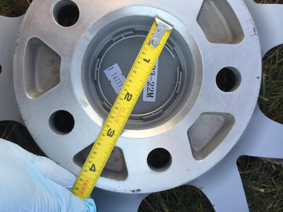

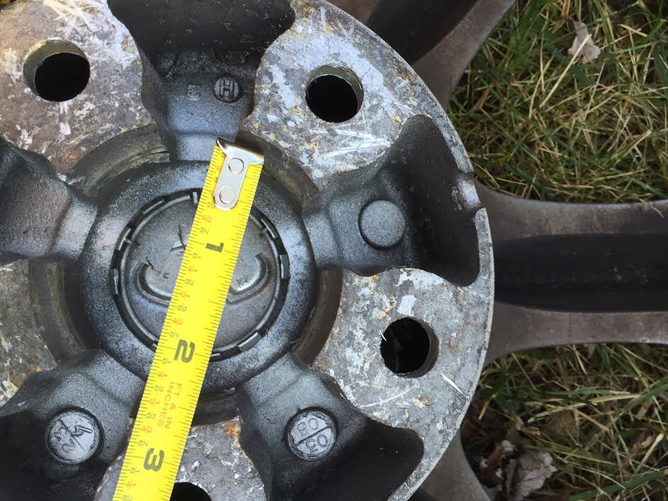

I think I found it out... does it make sense to say the new rims need Hub Centric Rings?
The Stock OEM rims seem to measure roughly 2.5 inches and the new Niche M131 rims seem to measure 2.75 so I assume that's why the rim has some play in it?
Does anyone know what size MM the stock rims are by chance?
Thanks..
Chris
Attached Thumbnails What size rims do I need - 04 Coupe-new-rim.jpg   What size rims do I need - 04 Coupe-old-rim.jpg
Old Dec 10, 2015 | 10:57 PM
LI-G35Driver's Avatar
Posts: 410
Likes: 27
From: Long Island
Ok.. looks like I need the hub centric rings from 72.6 to bring it down to 66.1 since the stock rims for the coupe are 66.1 Thanks for listening to me work through this.
