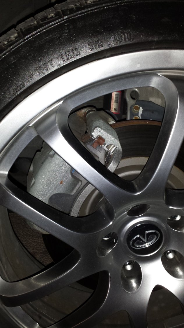

Dealer said my rear pads are 3mm
Need replacing soon.
But he said the brake components are
3rd party so they have to replace all that, whatever that means. $250
Should I just go to local import auto mechanic and have him replace the rear pads with same?

Pic brake

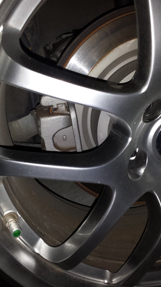

Old Apr 20, 2016 | 05:46 AM
dundermifflin99's Avatar
Joined: Oct 2013
Posts: 109
Originally Posted by BradMD_96
You have the Brembos?
Added pics

From the pics, it just looks like whomever did the pads before tossed out the OEM shims. Maybe that's what the dealer was referring to replacing? Typically other parts that get replaced besides the pads are the hardware kits (thin metal pieces in the caliper bracket at both ends of the pads) and dust boots on the slider pins.
