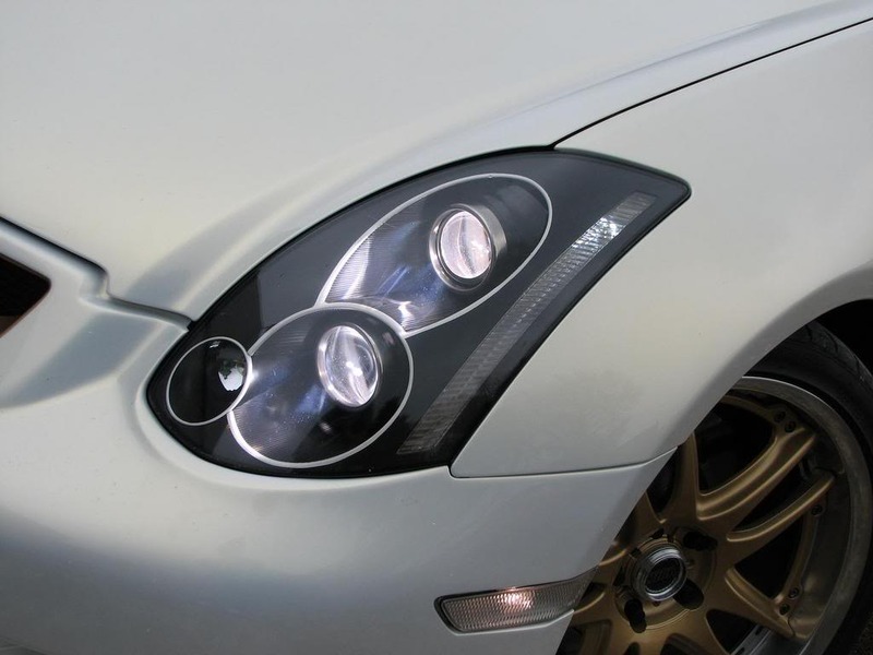

Hey I have a 06 g35 coupe and I want to do the dual projectors like this picture but I was wondering if and how do I change the top projector shroud? Do I have to cut it out and replace it with a new projector and shroud. Just trying to put together this project but wanna get all my ducks in a row...

If you want it exactly like the ones pictured on the sedan you will need to do a lot of cutting and sanding to make space for those exact shrouds as the coupes bezel is too small for that "Iron Man/Machine Gun" type shroud. Too much work if you ask me but here's a couple pictures and info on the shrouds he used and also a link to his build.
https://g35driver.com/forums/media-s...on-thread.html
Originally Posted by JDM_Cain
Got these bad boys back today thanks to Eric at Baus Auto...ZKW-R Quad Retro Fit with Machine Gun Shrouds. We also painted the foglight lens yellow and installed a white CCFL (Demon Eye) behind it. We used 6k HIDs in all 4...I expect to have these on by this weekend.

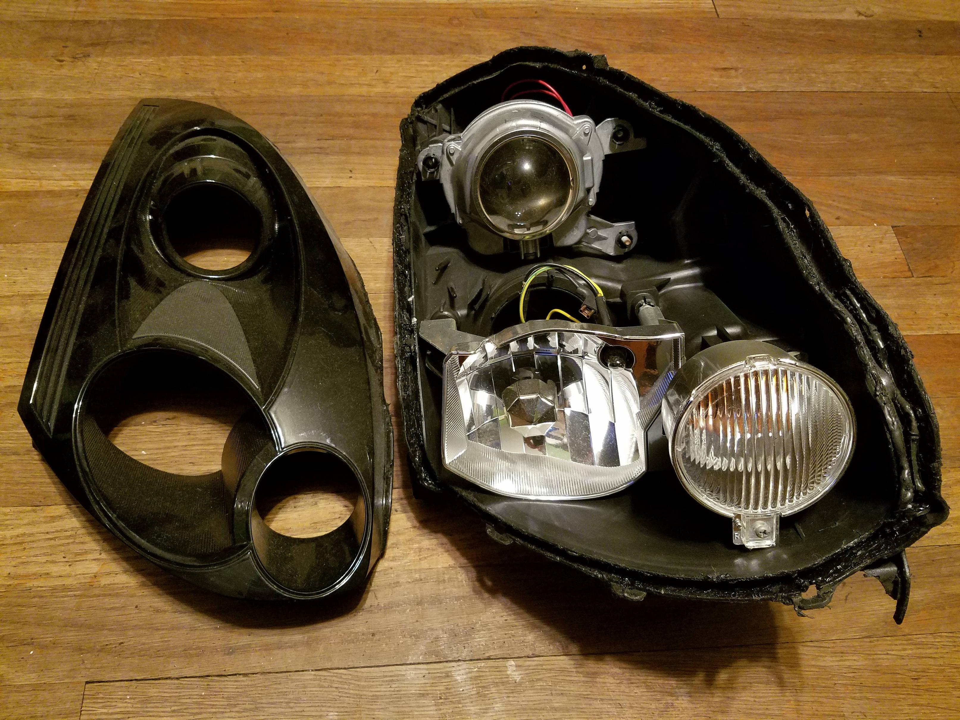

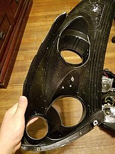

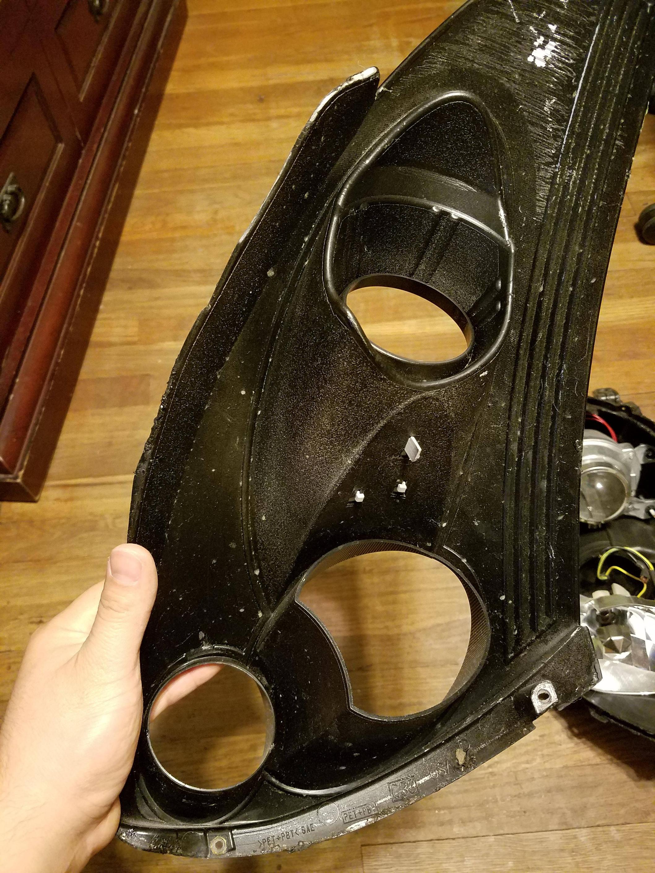

Originally Posted by Chpmndm
But can I use the mini shrouds? Ando do the top projectorspot come out in my coupe
Yes you can use smaller shrouds for an easier fit. Can you remove the top projector assembly? Yes. The top projector shroud? No. Here's some pictures of my 06 projectors so you can see what I'm talking about.
