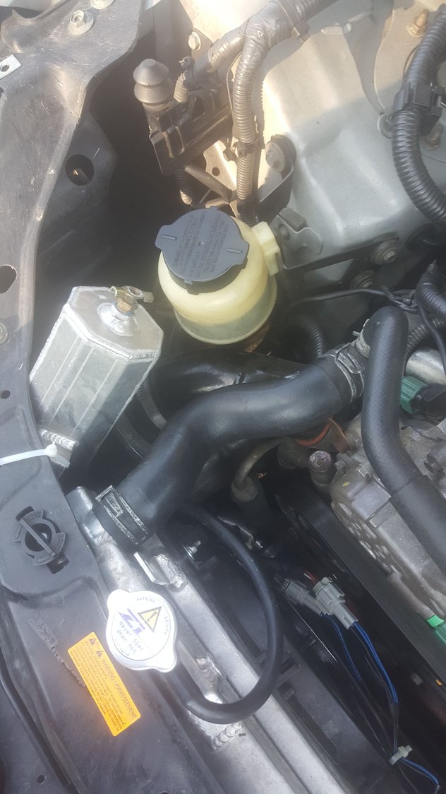

Relocated my coolant reservoir temporarily till I can really dig in there, but it suffices for now. I was worried about it being right over my intake, but it seems to be holding up...ac heat comes right away, instead of me burping the coolant basically every start up (the can was located in the bumper at a shallow horizontal like angle lower than the radiator, when the coolant would expand, it would come out of the can, but because of the shallow angle, would suck in air when cooling off.) Temps have stayed around 190-210 steady for oil temp, so I'm fairly pleased with that.

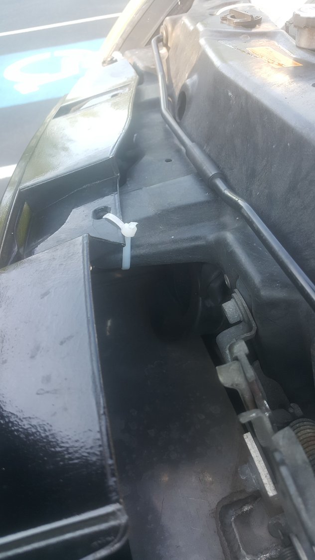

Haphazard af, but it was the only place i could put it without making a mess at work in the parking lot.
There a gap i can mount it to, outside of the engine bay, next to the intercooler passenger side. This way, if coolant were to push out, it'll be more controlled and NOT ALL OVER MY ENGINE.

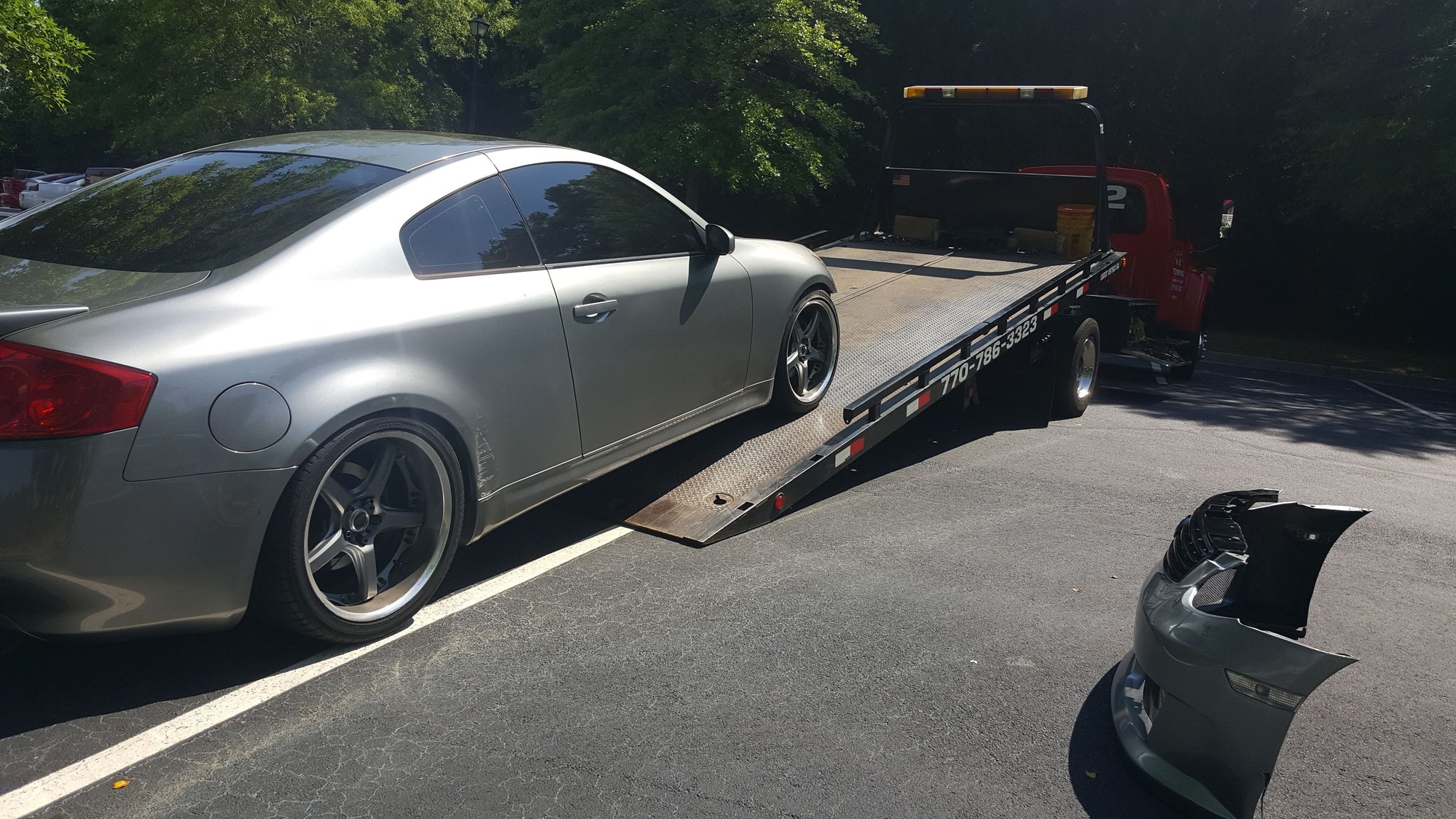

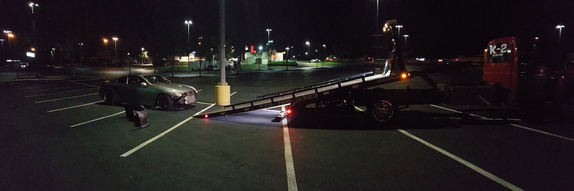

Spun bearing as of 5/08. It's at my boy's shop, Oden's Customs & Restoration waiting for the teardown and inspection.
Heard it on the interstate...luckily, i was at my exit. Shifted to neutral, and she cut out when I let off the clutch. Put her up on stands and took a peek underneath. Thankfully, I think I had just caught it in time enough to prevent irreparable damage. Video is on my ig, @hooey_b.
Loaded her off to my friend's shop. Used K-2 towing, and surprisingly enough, all i had to do was remove my front bumper to get her on. Highly recommended if youre in the south/east part of atlanta.
