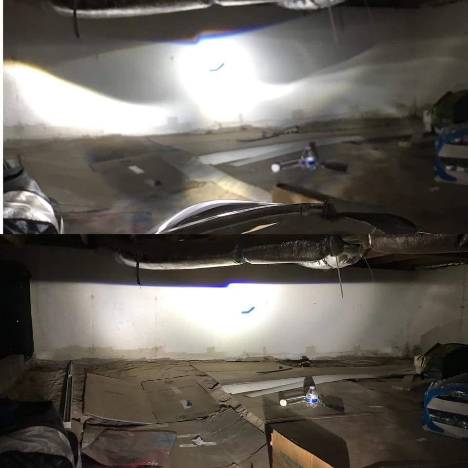

Please don't install LED where proper HID belongs. The G35 comes with a really Good HID projector and the sedan has a good modern reflector.
If your car came stock with Halogens, leave it halogen.
The way Halogens reflect light, can't effectively put light on the road with HID or LED. It's just science. Google HIDPlanet for official studies.
DO NOT PUT LED IN A G35 IT IS NOT AN LED REFLECTOR OR PROJECTOR. YOU LOSE DOWN ROAD VISION WITH LED.

Here (pic) is an example of LED in an HID projector housing where it was designed for HID. The bottom shows the factory D2S bulb while the top shows drop in LED.
I would recommend considering replacing those with stock headlights. Spider is about looks, and not about seeing at night.
