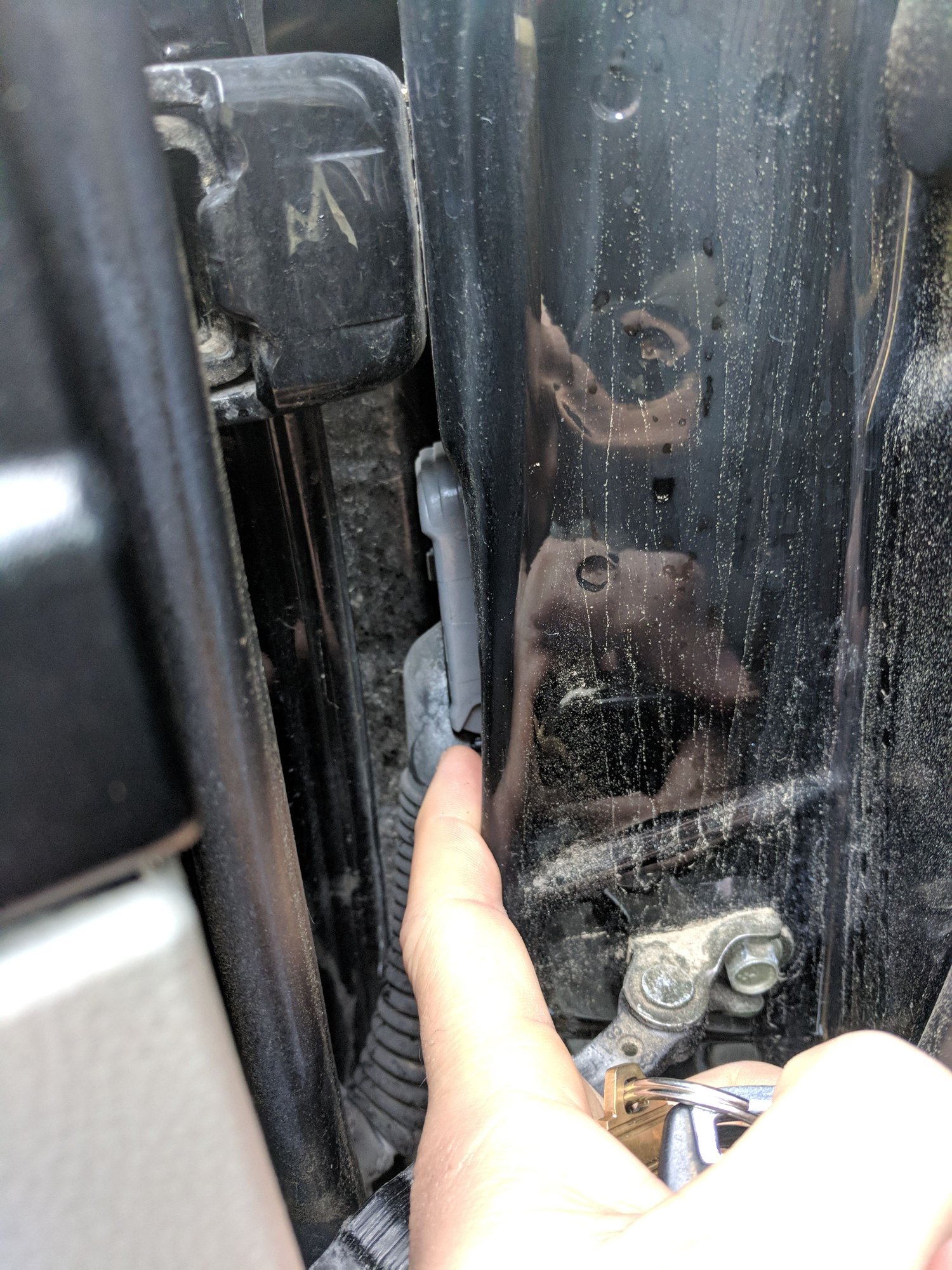

have any pics ?

Door check bolt
Harness connector snaps off, tab is on the back side.
Hinge, remove 2x nuts on upper and lower hinge.
