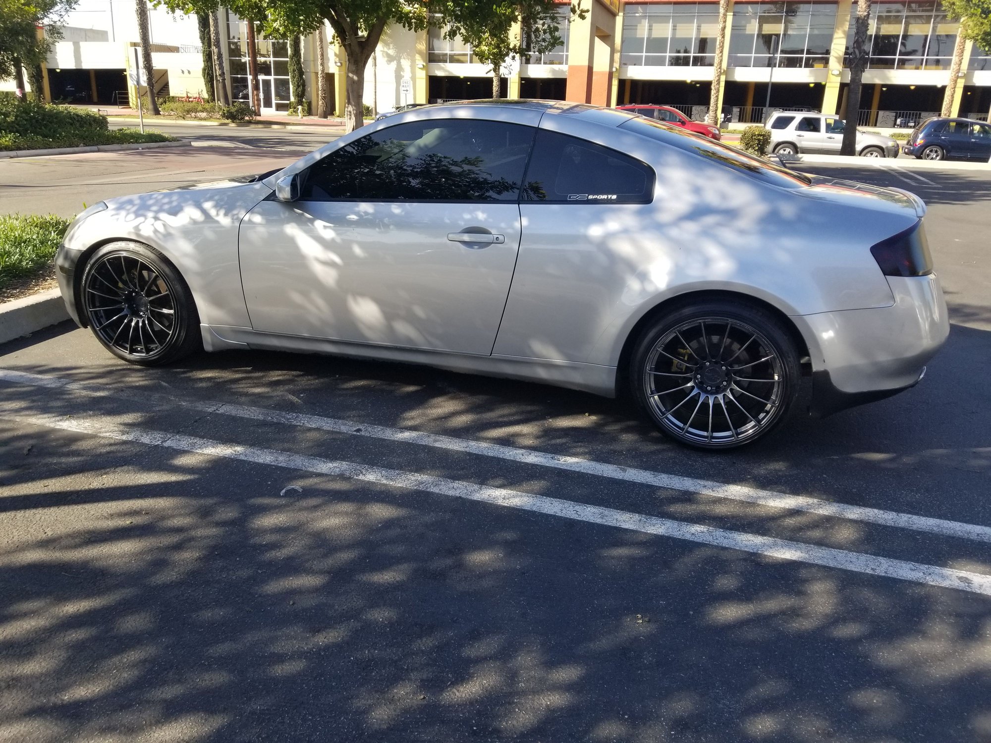

Wassup.. so i got some 20" xxr and the gap on the front looks clean. But the rear has a not so satisfying gap and was wondering if i can add a 1" drop with a spring and leave the front as is. Also im not looking to drop it too much because i live in L.A. and the streets here are garbage. Specially where i work at. Anyways i was wondering if i can get schooled on this or if anyone has done this.. i dont want to roll my fenders either.

Here's what she currently looks like.

The easiest solution if you're happy with the spring rates would be to just trim down the upper seat on the rear springs. Basically there's a big piece of rubber that you can trim 1/2" off to lower the rear 1/2", this is obviously a non-reversible process so if you change your mind later you have to buy new rear spring upper seats.
Really easy to get them out too, google search something like "G35 350Z rear spring upper seat mod" I'm sure there are plenty of people who did a write-up already.

Get the H&R lowering springs and install it in the back. Should drop it nice n even.

That sounds good It has like 1.2 inch drop..

Theres a guy selling just his rear H&R springs, but its for a 350Z. From what I've read, that would lower your car another half an inch lower than the H&R springs intended for the G.
Might be a little too low for u.

Yeah thats like 2 inches. I just want the gap to be less visible like the ones in the front. The rear wheels are really wide and i dont want to roll the fender. Ill buy the h&r springs, the price is reasonable.

Expect to need toe bolts and camber arms for the rear. Not that big of a deal, but, when you drop it, you’ll be significantly out of spec (at least I was with a modest drop in the rear).

I was thinking i just had to slap the springs on the shocks..

Sorry bud, doesn't work that way on our cars. I will suggest you stay away from anything from Ichiba, too many parts have failed all across this forum, I had 3 parts that all went t!ts up at some point in their lives. Search for the Ichiba fail threads here, there are more than a few.
