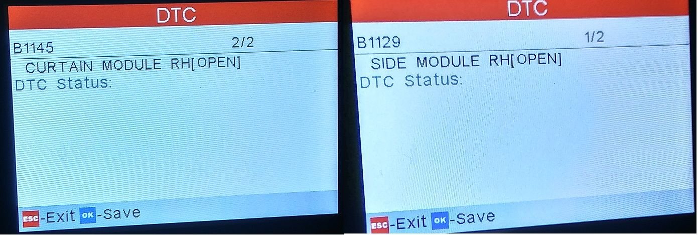

i have these 2 codes B1145 CURTAIN MODULE (OPEN) / B1129 SIDE MODULE RH (OPEN)

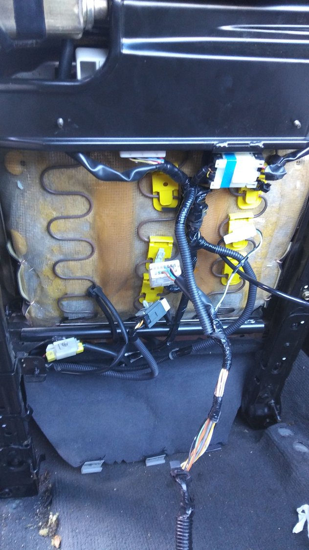

Infiniti did the recall the light does not blink on Acc removed the passenger seat , unplugged and re-plugged everything , what's next
i did not see the airbag yellow connectors ?

Was this ever fixed? I have these same exact codes : (

Here's a link to the TSB, you can just do the repair yourself if you want.
https://static.nhtsa.gov/odi/tsbs/20...44443-7463.pdf

Also, make sure you reset the SRS module a few times if the code doesn't clear. It doesn't always clear on the first try.
