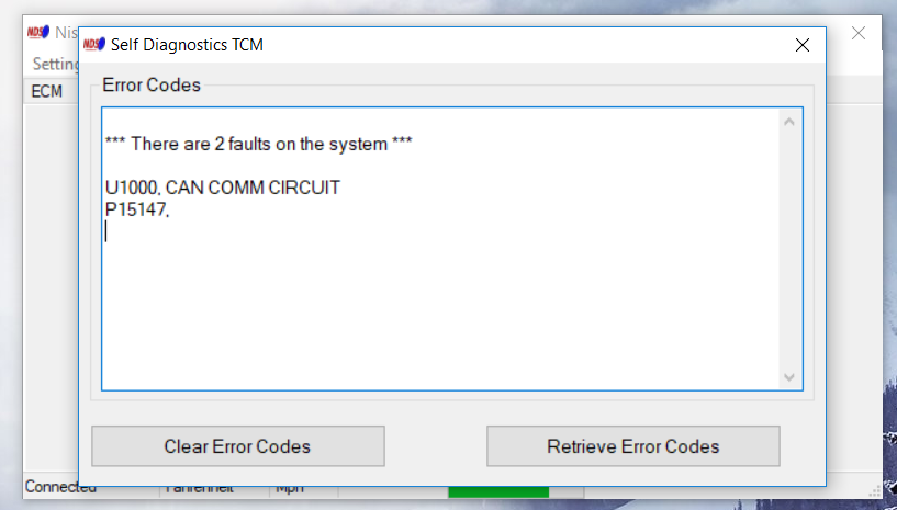

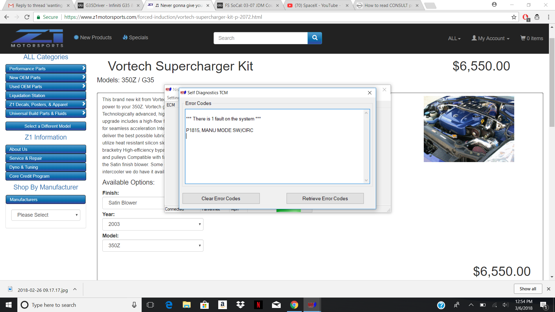

Check your tcm for codes. It's probably throwing a code but it won't show the check engine light. Mine does the same thing and always stores a code. Manual mode has a mind of its own
