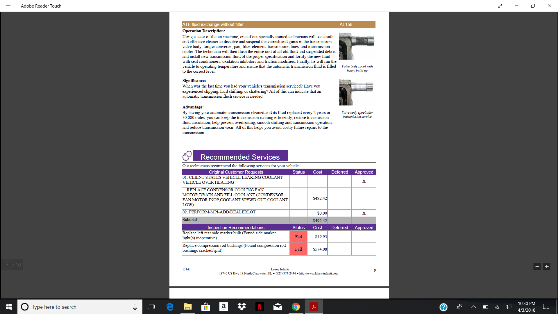

I actually just found this the other day looking through my emails. It's hilarious to me.
Attached Thumbnails Any alignment experts out there?-screenshot-172-.png   Any alignment experts out there?-screenshot-173-.png
