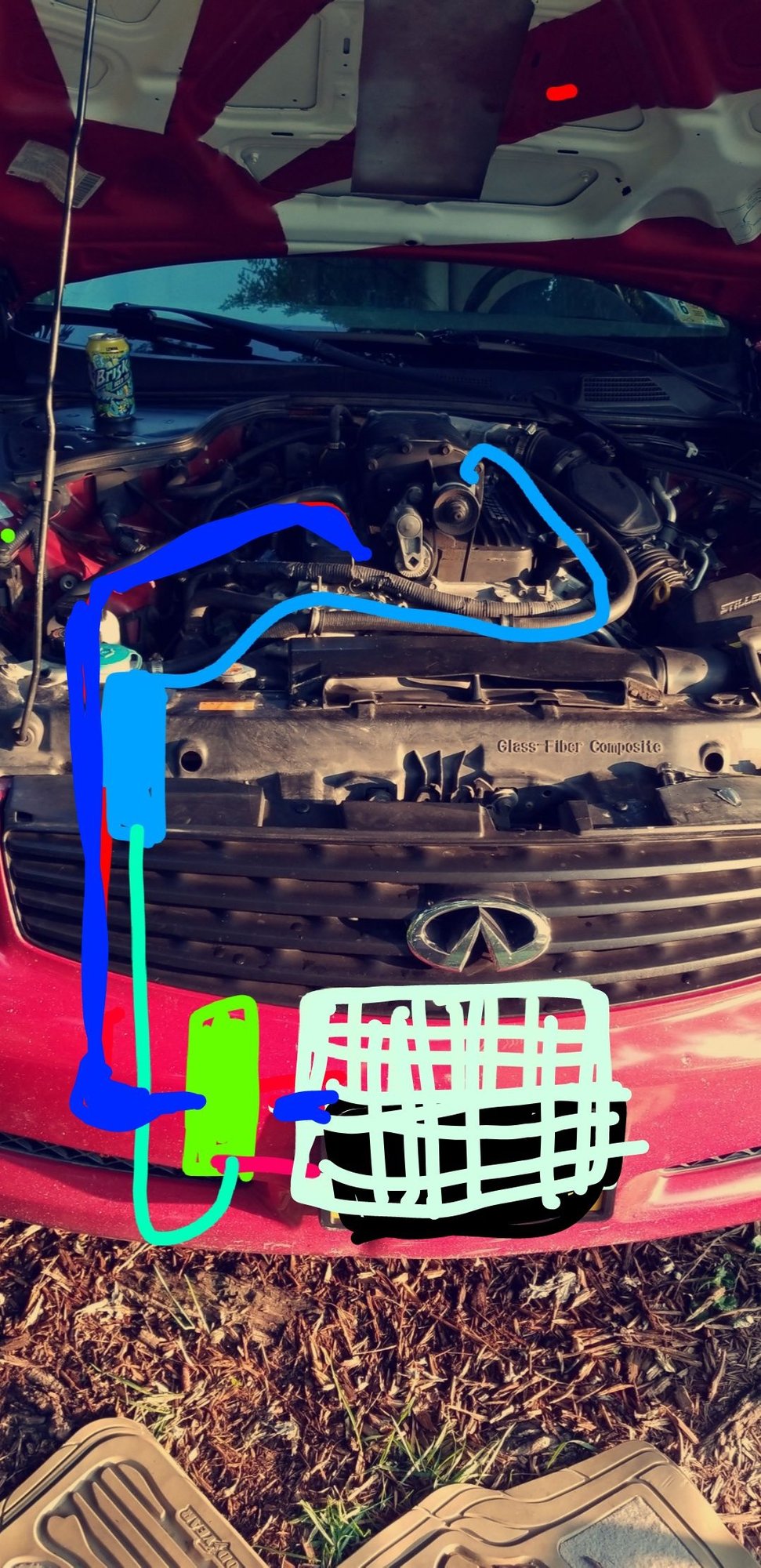

What goes in this (inter cooler) reservoir, any liquids? It was completely empty when i checked
i looked online and read the manual and it seemed like a coolant reservoir so i filled it with coolant. But now im not so sure if thats what its for because i lifted the car and looked under. This is what i saw
Each color line is a different hose
The light blue is the (inter cooler reservoir) which has a hose connected to what i think is a pump
The heat exhanger at the bottom (inter cooler/little radiator looking thing with a stillen logo) do any liquids go into that? I'm completely lost

Dude WTF??? Did you seriously put something in your car that you have no idea if it even belonged there? And you bought a supercharged G which you know nothing about, wow.
I really want this thread to be a joke because I am baffled at what I just read but I digress and will make a couple of sane comments for the moment. Before you do ANYTHING else you need to get that car to a shop that has SC experience to give it a complete inspection top to bottom and back to front. I wouldn't even start it ATM, you might have put coolant in the right place but if you didn't that move could be catastrophic and cause massive problems for you. Looking more carefully at your light blue line it seems to go into the valve cover unless I'm seeing it wrong but if it does uh oh. Read as much as you can on the forced induction thread and better yet, the same thread on my350Z.com. Very knowledgeable members on both sites but the Z guys do it a lot more to their cars so there's more chatter over there. I'll just shut up now and move on but GL, hope everything turns out OK for you.........

you should have just added water but antifreeze wont hurt it and the 2 hoses that go into the manifold are for the intercooler under the s/c.The front mount is for the water to air heat exchanger and the pump should be next to it.I would keep checking the level and if it goes down you have a leak as its a sealed system.
I would def get a compression and leak down test on the motor one good thing is the stillen dosent make much power so the strain on the motor isnt that bad and make sure the fmu is under the battery tray cover.

so i fill it with coolant? if so it doesn't have a max / min fill line
either will be fine and i would also use water wetter and since you said it was empty fill it to about an inch from the top and let it run so the pump can purge the air out.

alright do i fill it all the way to the top so that the coolant goes over that hose line or under that hose line. from pictures ive seen it looks like a return line
it has no max fill line so idk
the manual also says to change the supercharger oil every 100k miles, the car has 98k on it. The manual/s dont show how to change the s/c oil
