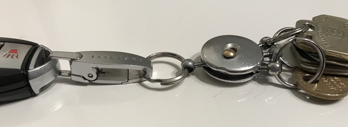

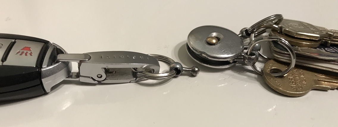

Clunky wad of keys in pocket is one of my major annoyances, besides wearing out the fabric. I've pruned down pretty good since taking the pension, and I don't keep my wife's fob on my keychain. Also, I have the absolute best key holder in my entire life.
