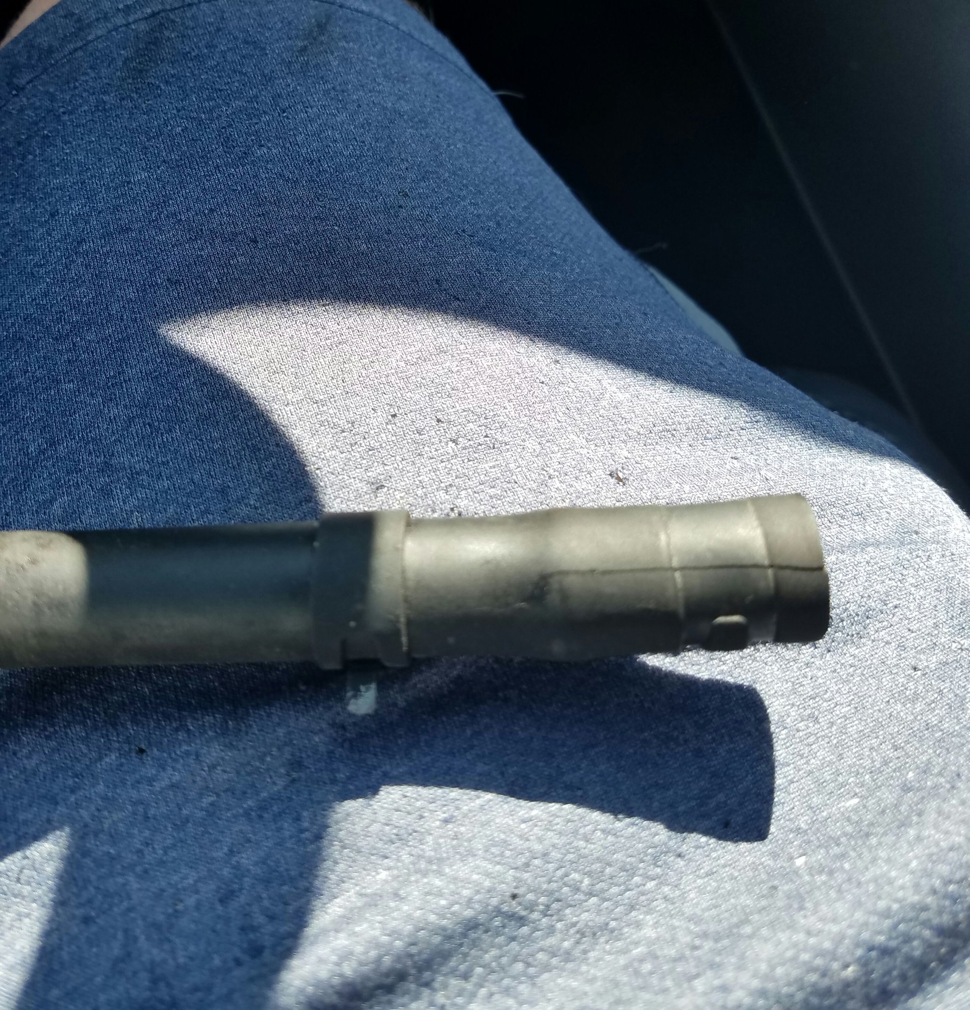

You %100 have a vacuum leak. I had the exact same noise after replacing valve covers. After taking everything back apart I ended up finding a cracked hose. This isn't a video showing the leak, but I made a thread about the same noise

Darn, which hose was cracked for you? It may be the same one haha. and how did you find it? I don't suppose you just inspected every hose. all of mine feel good, not fragile.

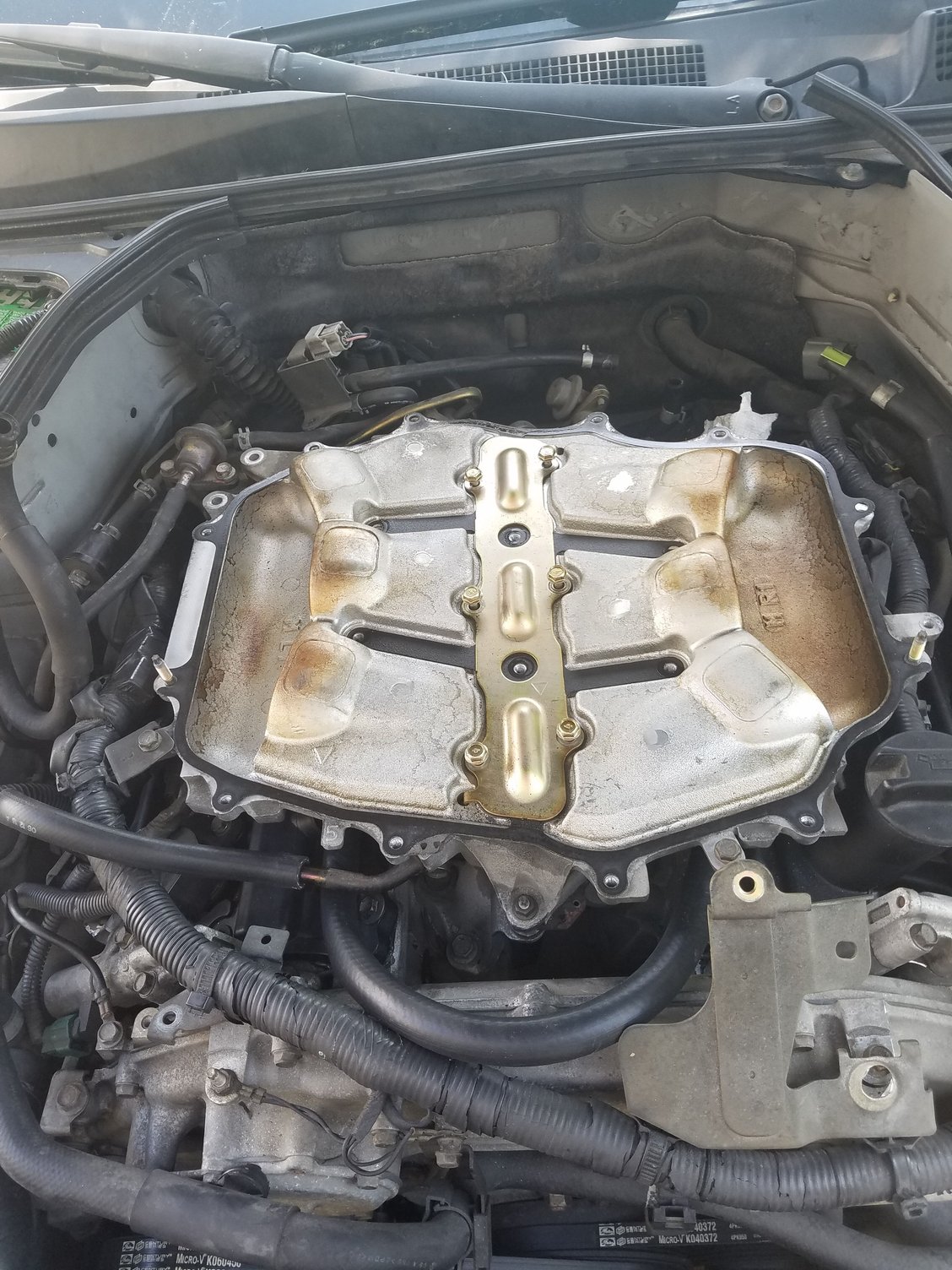

I pretty much took most of the intake apart including the plenum until I found a cracked pcv hose. Pretty sure the crankcase ventilation hose cracked as well. Take the engine cover off to get a better view of things.
Pcv hose
Got some heater hose as a temporary fix and ordered a silicone kit from z1.
You can see the two hoses near the plenum that look new compared to everything else
