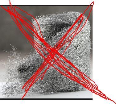

When he says "steel wool" he means those spiral scrubber pads, do NOT use that fine steel wool that peels apart or you run the risk of destroying your engine if pieces get ingested through the intake.

The steel wool increases the surface area inside the can to give the oil more to condense on, it acts in a similar way to a filter. I caught about twice as much oil in a 3000 MI oil change after adding it.
Honestly I'm just using normal steel wool, I made sure the wool I used was course enough there was no chance it could be sucked through the tiny exit hole in the catch can.... but very good point forgot to mention that lol
