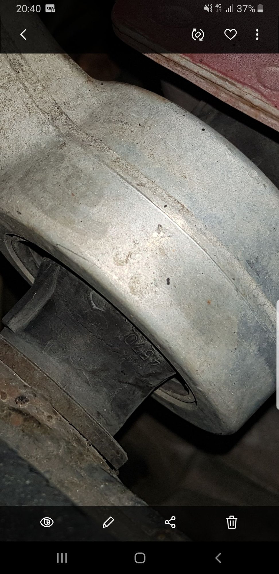

Thank you for explanations. I didn't use right names for those parts. I got changed transverse link what my mechanic call lower control arm but another one he mentioned is bad is actually compression rod. I don't wanna change another part what actually doesn't need be changed. The noise is coming from strut mount or compression rod. There is nothing left, maybe shock but it looks good.

Nobody will be able to find a bad compression rod ball joint without pulling the arm first, there simply aren't any symptoms unless at very particular points of the suspension travel with certain loadings

Changed sway bar link one more time, new one was actually lose so i got the another one for free. Compression rod bushing looks worn but when we lifted car you couldn't move that in anyway. I had compression rod ready for replacing but mechanic said that he is not sure, can be shock/arm. Shock is not leaking, strut mount doesnt move, car is not jumping.
