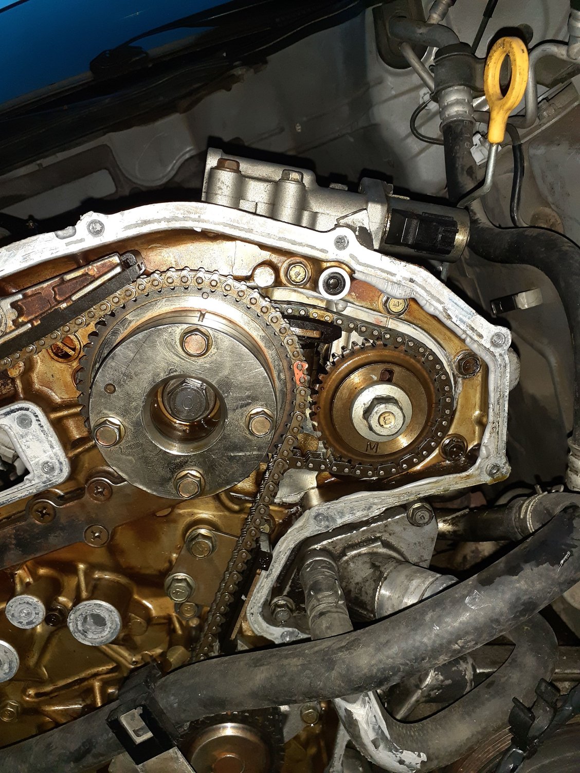

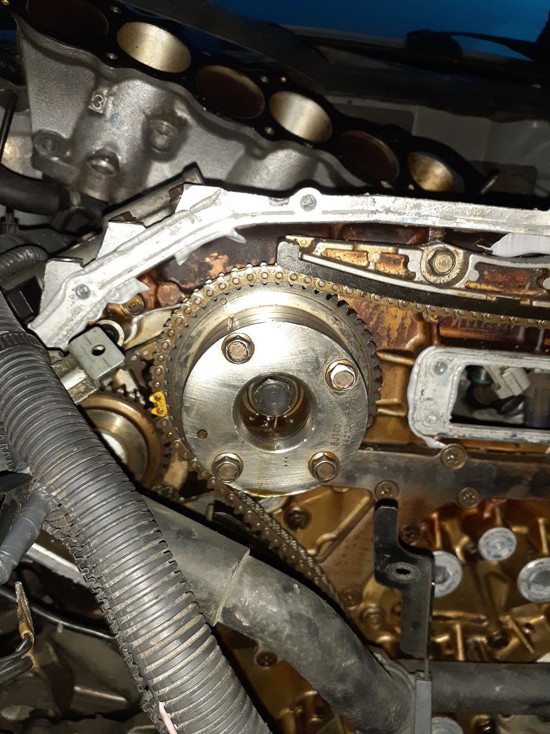

At tdc
At tdc
At tdc

Did you double check timing after releasing the 'grenade pin' on the main timing chain tensioner?
The yellow & orange paint marks are intended to line up with the small dimple marks on the cam gears and crank sprocket respectively, but they are 'seeking' after you rotate the engine over. You can re-check by rotating the engine over a few times by hand and see if they all line back up.

well yes but then I rotated the engine to make sure the valves weren't smacking the piston. I rotated the engine a good 10-15 times but I never rotated back to original tdc.
maybe rotating it might have skipped a couple teeth?

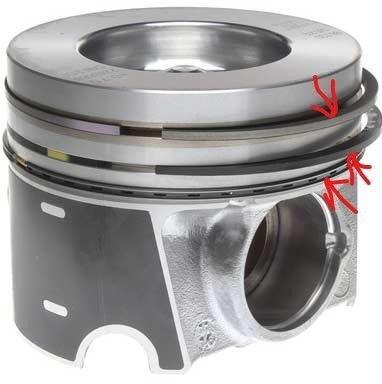

Not exactly true, if you add oil to the cylinder and the compression jumps that just means the rings are destroyed and the OIL is what's sealing up compression. The oil will quickly burn off (couple of seconds) once the engine is running and then you're stuck with leaky worn rings again.
The piston rings are made of METAL, they don't expand (except from temperature), you pour in the oil on top of the cylinder and it helps seal up the leak temporarily.
Rings don't get stuck closed, I think you have a little misunderstanding about what the rings are and how they work. Look at this picture.
Piston and rings, 1 - piston, 2 - set of rings for each piston.
Now the rings fit into those little grooves at the top of the piston, they are filed to have a certain gap because it's not a complete circle.
Here is a picture of the rings installed on a piston. You can see all three rings on the piston.
The rings are then compressed and the piston slid into the cylinder in the block. You can see each of the 3 pistons at various positions, the back one is set at "top dead center" which is the top of the compression stroke.
