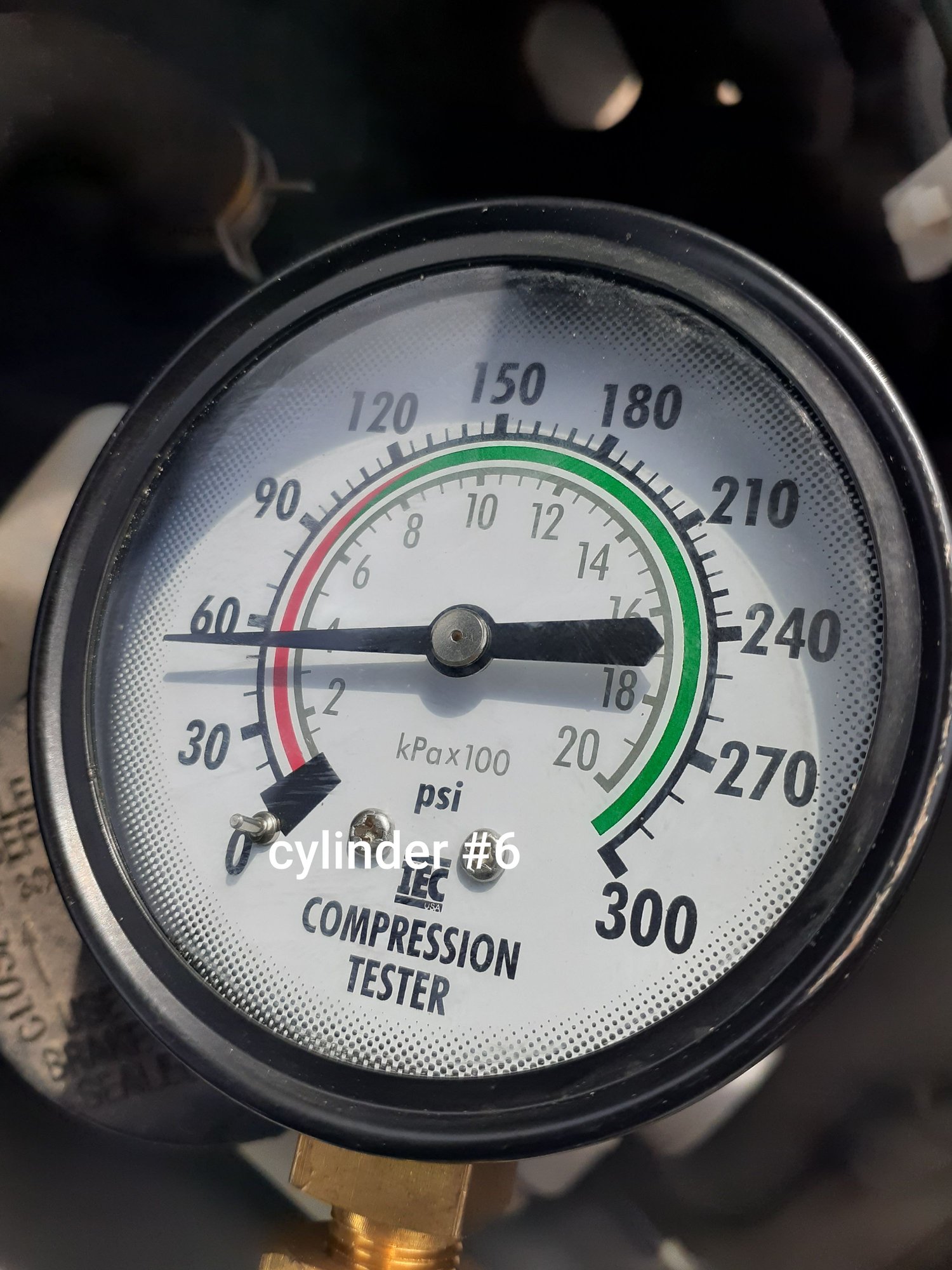

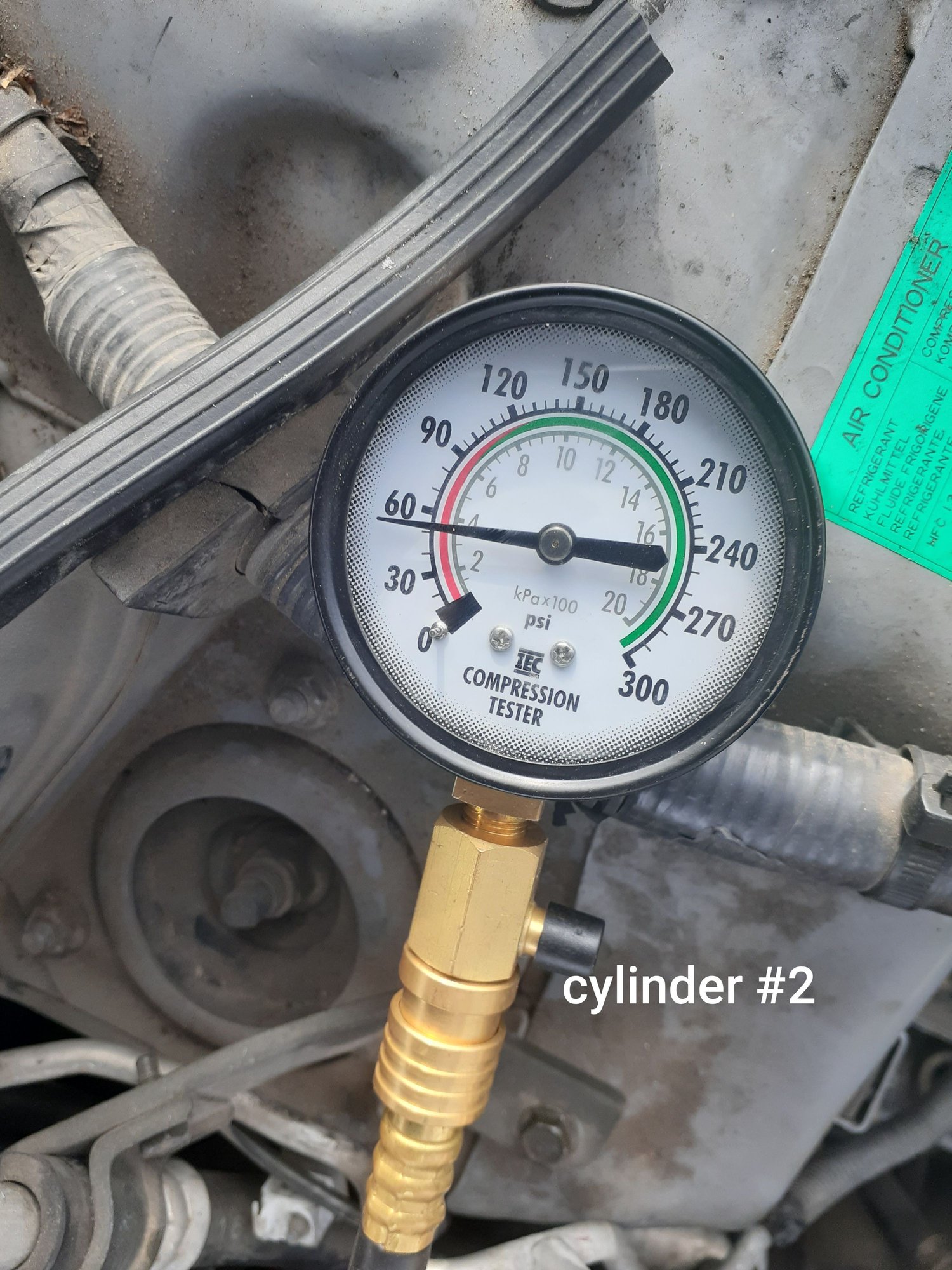

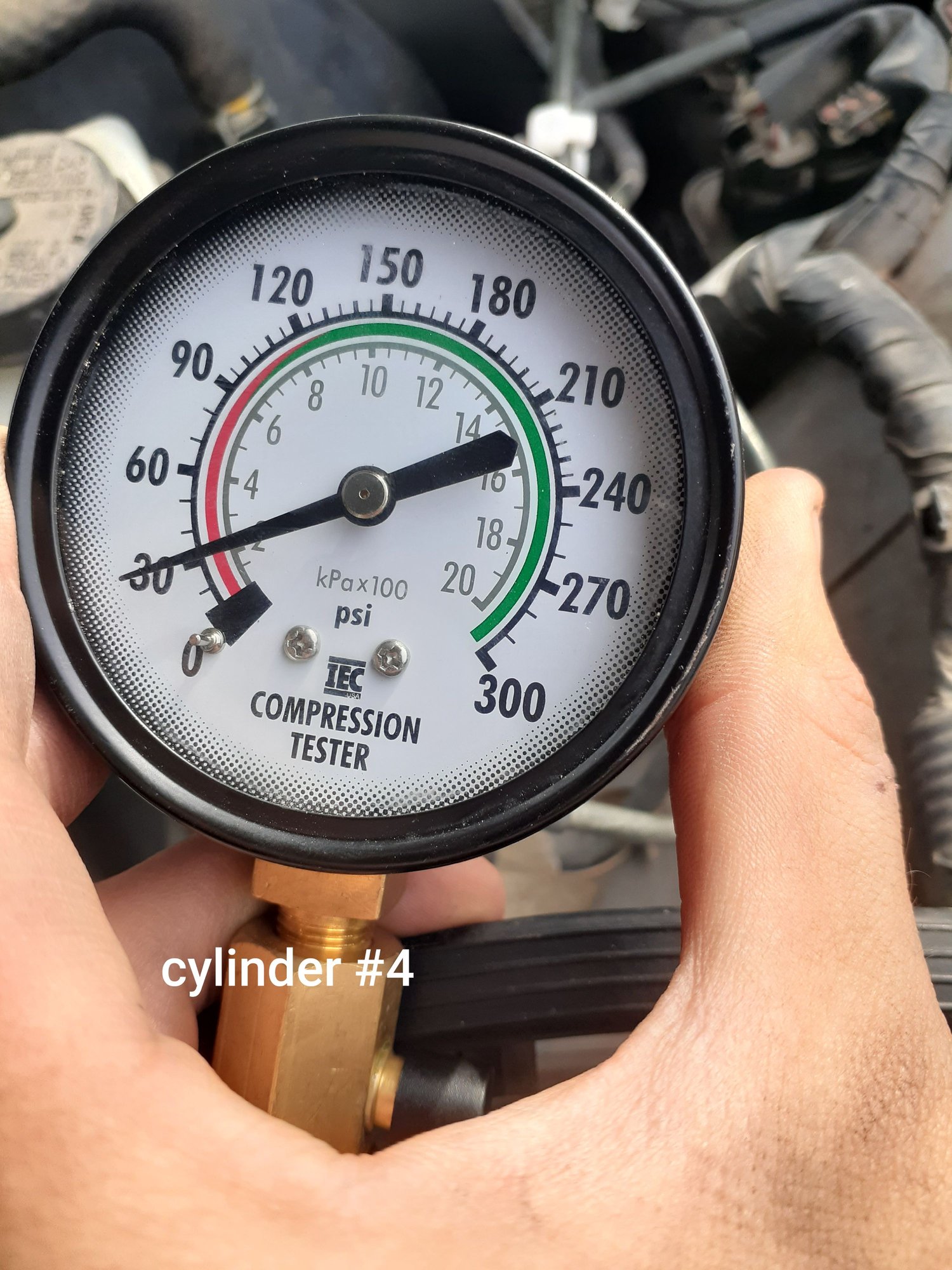

Old Mar 15, 2020 | 10:30 PM
Anthony gamez's Avatar
Joined: Jun 2019
Posts: 20
Needs work
Low compression
Left bank
Left bank
Left bank

Gotta do a leakdown test to determine where the air is going, compression just tells you that you have the leak. Leakdown lets you diagnose WHAT is leaking.
All 3 of your compression tests on that bank are DRASTICALLY low, you should see a minimum of about 115-120psi for a REALLY worn out motor (250k hard miles). Normal high compression psi will be 185-200+
Are you making sure to rotate the engine 6-7 times during the compression test? You'll see each compression bump on the gauge, typically I just count them out and then just wave my helper to stop cranking when I have the reading.
Did you follow the FSM for aligning the timing chains when you assembled it the second time?
yes I did but maybe I did something wrong or it jumped a tooth. I rotated it 4 or 5, or until no compression was being produced
