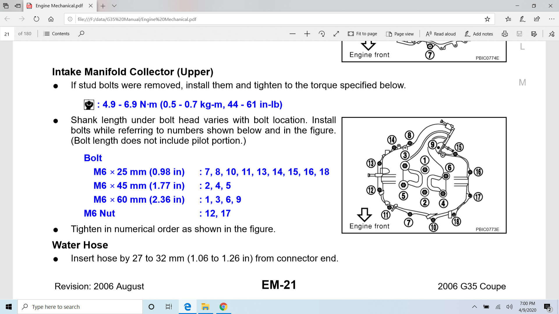

Agreed, hopefully you got the whole kit https://www.z1motorsports.com/cylind...ge-p-7167.html I got this last summer, finally did the install and completed in late October/ early November. No longer have the oil build up on the exhaust it seems either. But cleaned out the MAF sensor, changed out the plugs while everything was apart. I had such a smell of oil coming in the car, it seemed especially if I got on the car at all.... happy to say no smell, no oil drip and I have only put on 1200 miles or so since doing it so cant comment on the oil consumption but assume since I do not see even a drop of oil in the engine, its all good. Took me about 3 days to do a couple hours here and there... if you get up on a nice day bright and early you should be able to knock this out in a day with no problem. Remember to label each bolt with tape where it goes as you take them out of the plenum as they are all different sizes.. take your time with it. Its a fun project if you are in that kind of mood and having the time.
The fsm has the length for the bolts and location. Only 3 different sizes
