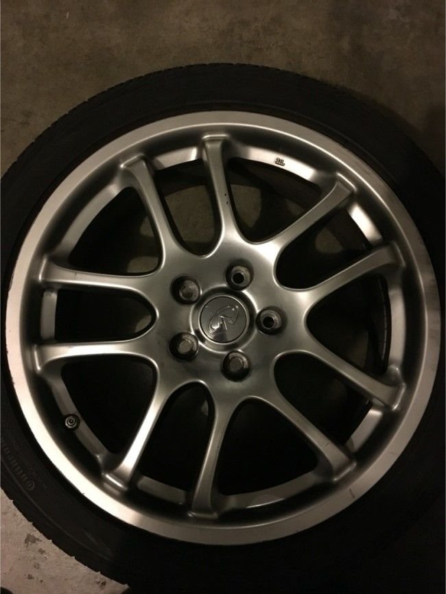

I've got a 2006 gray G35. A simple cold air intake, and test pipes.
Stock wheels, good fitment?
Hi! it's me again coming back to ask another question.
I'm looking for an aggressive look but not too much poke look on this particular wheel. What size spacers should I get? What do you guys recommend? I like the stock wheels too much, and don't really see myself going with after market wheels unless it's some Vossens but those are way out of my budget for the time being.
Thanks!

https://www.rimtuck.com/search/thumb...odel=G35+coupe

20mm hubcentric spacers up front
25mm hubcentric spacers in the rear
I run stock (or close to) stock tire sizes with no rubbing. Love the way it looks with the stock wheels.

you may need to get extended studs depending how big the spacer is
My spacers are "adapters" with a second set of lugs built in. I believe this is the safest way, as long as you use thread lock on the internal lugs and check torque after 50 miles or so.
For reference, here's the 25mm spacer I have. They don't seem to offer 20mm anymore, but they did. ​​​​​​
