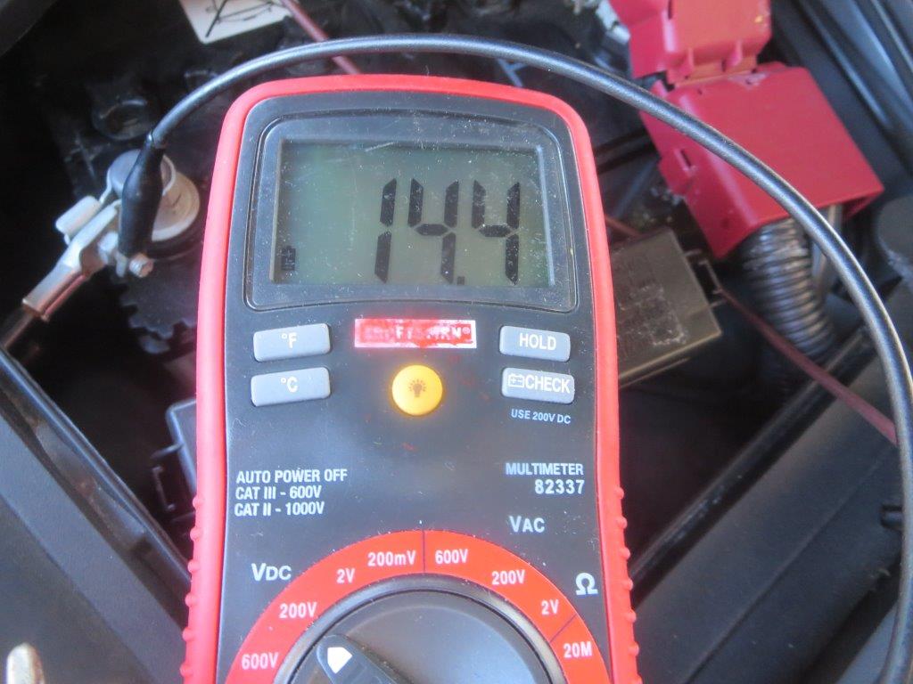

If the battery dies while driving, the alternator is not charging it. This may indicate that the alternator is shot or the battery has a shorted cell and cannot be charged. You also mentioned it is hard to steer, which makes me think that the belts may be loose. There may be other issues such as broken or shorted wires, bad connectors or bad ground wires and /or connections. You will need a service manual to trace the wires. See the link below. Check all the wires you said the previous owner left hanging loose to make sure they are not shorting out either between them or to ground. Good luck.

If the alternator is good you should see
