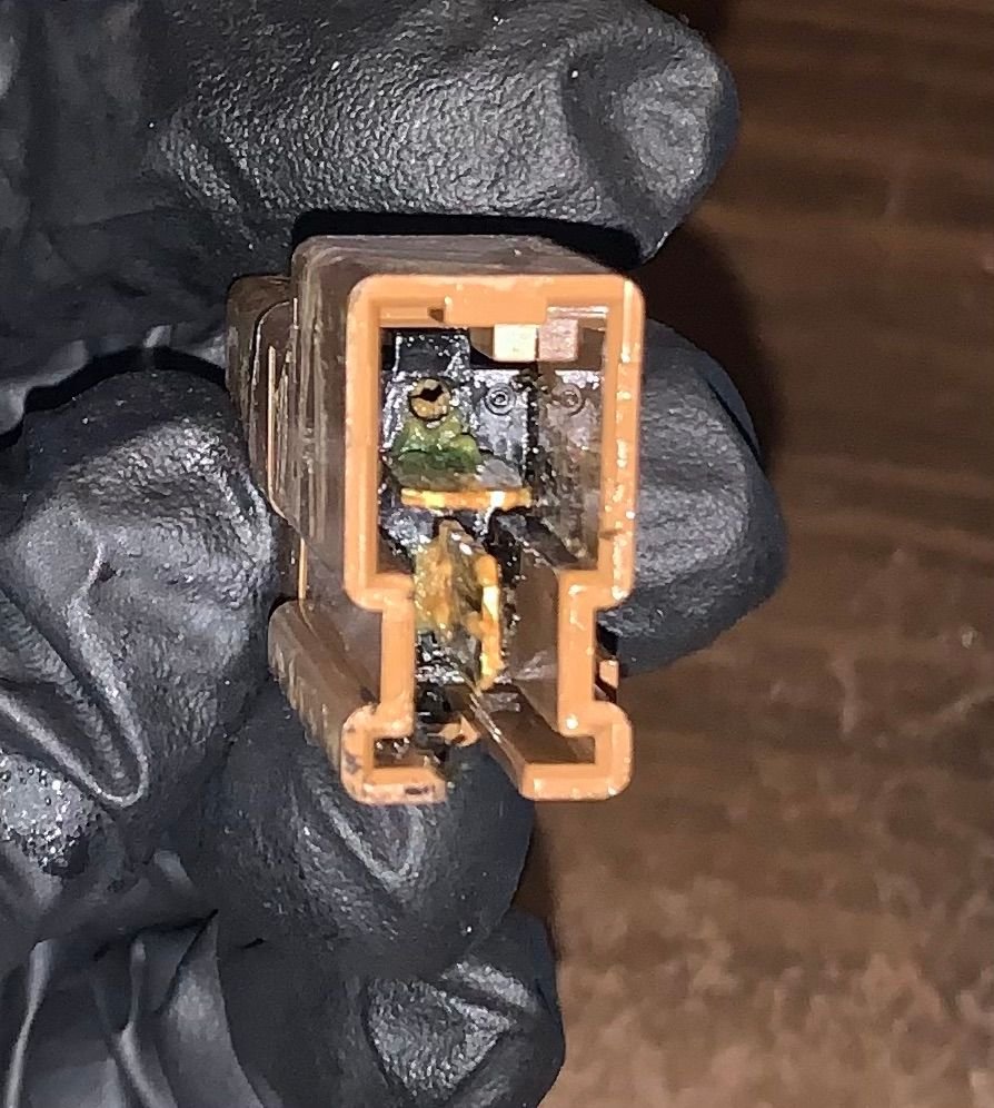

Update:
I kept reading the service manual about inspecting the coil packs. One part said to inspect the condenser. I'm like what the hell does the A/C condenser have to do with the coil packs. So there's this thing called a Condenser Ignition Coil. Mine was hidden and wrapped onto the main wiring harness with electrical tape right above the Bank 1 coil packs. I removed the electrical tape to expose the condenser ignition coil and harness. There was brown fluid oozing out of both ends of wire harness and also in the condenser ignition coil. It's a pretty cheap part, so I'm gonna wait until the morning and see if the Nissan dealer up the street has any. Clean up the harness and see what happens. That can't be dielectric grease, can it? It's really greasy. (Cleric, just saw your other post from last year explaining what this is... so essentially it's a capacitor that works as a coil pack "spark" regulator, right?).
Back of Condenser Ignition Coil harness. I'm not sure what all that brown gunk is and not really sure how to clean it.
Front of Condenser Ignition Coil harness. Gunk is caked inside of the harness bad.
Condenser Ignition Coil harness. Seems it was burning up.
Opened the condenser ignition coil and it was fried.

Holy crap, someone smothered the ever living F out of that thing with dielectric???
This COULD possibly be the culprit and yes they are very inexpensive. I'm leaning more towards a coil pack failing caused the condenser to fail which then causes intermittent spark issues because it's no longer able to rapidly discharge properly.
Basically it allows a large reservoir of electrical current to be stored up in the circuit, when the coil pack discharges it draws from this reservoir which then rapidly fills back up. The current draw of 6 coil packs all firing intermittently causes a "ripple" in the current, imagine waves on water, if you created another wave that would slam against the ones already in the water it creates a disturbance which can effect the flow. If you have a deep river of current it's not an issue, if you have a very shallow stream it can cause a momentary loss of water as one wave slams into the next.
This is more or less what the capacitor is doing, allowing for a larger volume of current to prevent hard cycling on the coil pack because it WILL cook coils by opening them without the current behind it, the voltage will spike to make the arc, create extra heat in the winding on the coil pack.
Don't be surprised if you do possibly have a coil pack issue that exists after you replace the condenser, I would give them all a very good visual inspection particularly for heat discoloration on the contact spring that's up inside the well boot, use a flashlight, if it looks brown/orange-ish replace it, that's usually where the damage STARTS.

Thanks... awesome explanation. It definitely shows you are an electrician or electrical engineer. P0304 has been popping up intermittently over the last couple of days. I went in to check the coil and spark plug today and that's when I saw the condenser/capacitor inspection in the FSM. I just checked coils 2, 4, and 6... no discoloration on the coil spring, it's dry and silver. I don't know if the brown goop is aged moisture/water, or dielectric grease... the electrical tape looked OEM. I think I'm the first person ever to service it. Is there usually dielectric grease in this connection? I saw some other 350z post were OP said that water poured out when he removed the electrical tape and connector. He was confused on how water got into the connection.

Yeah that's not a connection that normally would get wet unless you wash the engine bay which I am STRONGLY opposed to btw.
I've seen that kind of sludge in the field before (electrician, not an engineer, but naturally curious). It's just an abundance of dielectric that's a decade old and probably got really hot.
When you replace it wipe all that crap off, then apply a VERY thin layer of electrical anti-oxidation grease on the harness when you plug the new one in. If you want to make it a bit more moisture resistant you can wrap it tightly in electrical tape but that's probably unnecessary because it's supposed to be dry in the engine bay as long as you have the lower cover on and aren't spraying water in the bay. You probably won't even need to add more dielectric because there's so much up in the harness.

I pulled the terminals out of the harness. Cleaned out the harness and terminals and got pretty much all of the dielectric out. There's probably a very thin coat left on the terminals, so I'll leave them as they are. I don't have any anti-oxidation grease on hand, I'll have to grab some tomorrow.

Glad you found it, btw that dielectric grease is in fact factory. My 240SX and Silvia all use that same part and are pretty coated with that stuff. I'd pick up a tube at local auto parts store and lube it up when you install the fresh one. Feel free to go to town like they did at the factory in my opinion. Cleric provided a pretty good breakdown of what that thing does.
