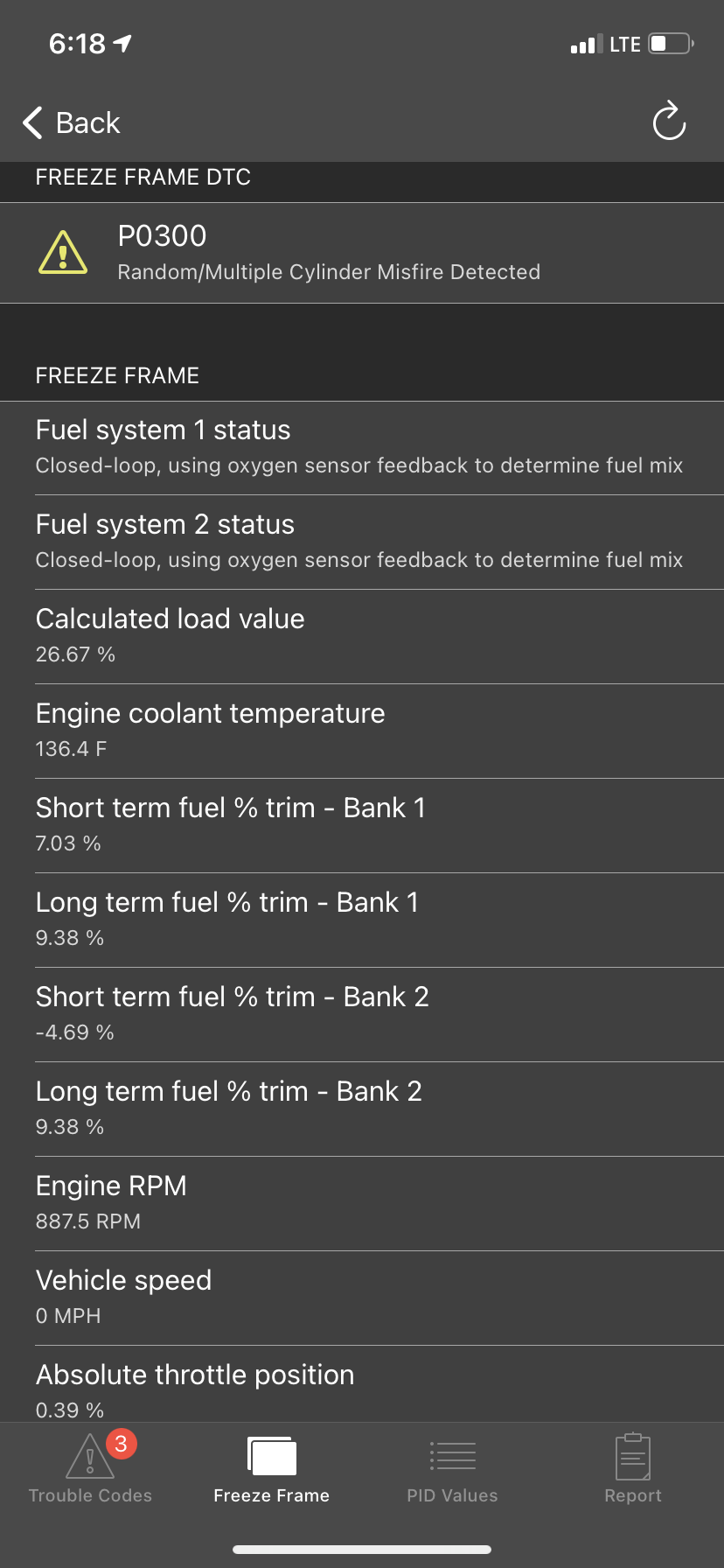

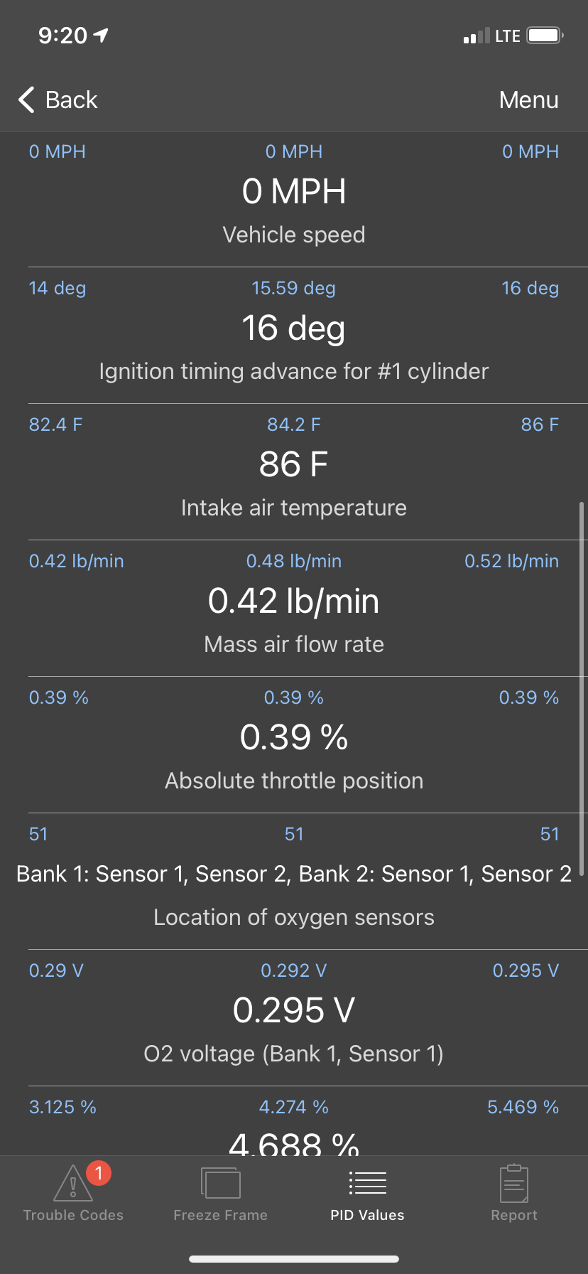

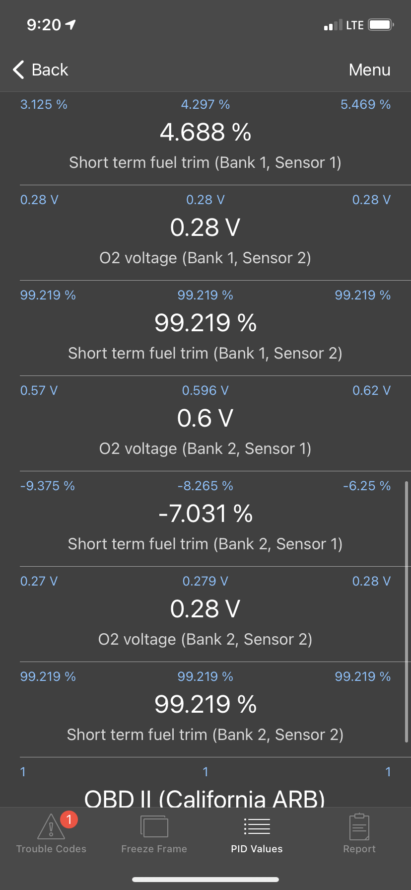

Thanks. I reinstalled the condenser ignition coil this morning. Went for some test driving... and P0300 is still there. I set up a diagnostic appointment online with the Nissan dealer that I bought the part from this morning. Hopefully they'll run a diagnostic with my mods and provide me with a strong answer. With all of the electronic parts being new, I'm starting to worry that it's a mechanical problem. I also just notice my fuel pressure is sitting a little high at 54 psi. FSM says it should be approximately 51 psi. I don't know what the tolerance of "approximate" pressure is. I've included some info from my scan tool and app below.
P0300 & P0304 codes
Freeze Frame for P0300
Freeze Frame for P0304
PID values #1
PID values #2
PID Values #3

One thing that stands out to me is that Bank 1 fuel trims are a bit higher than Bank 2. Like one has +9% while the other side has -4%. Have you had the injectors cleaned yet and flow tested?
