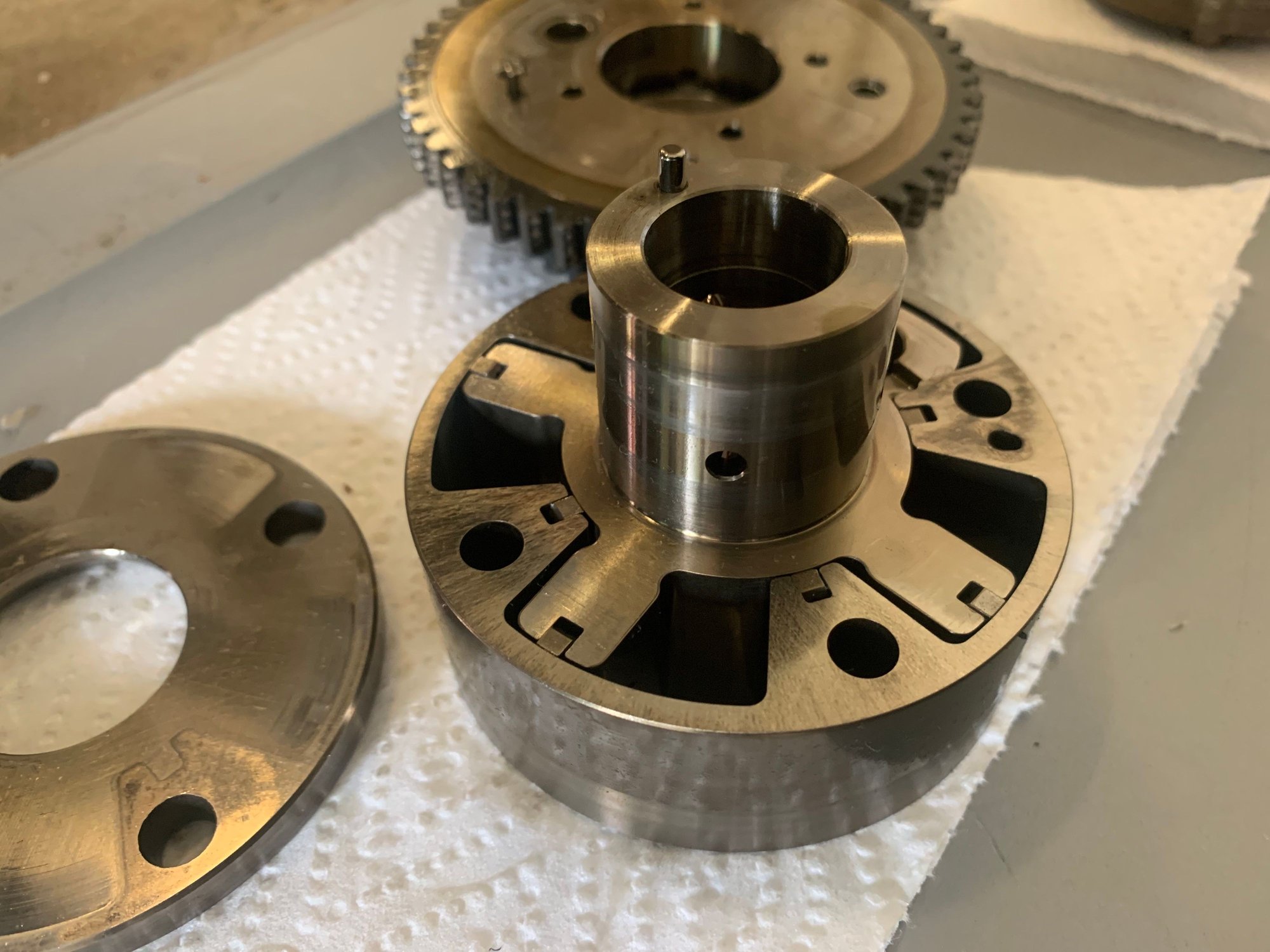

I took the cam phasers off and disassembled them. There appears to be no damage (cracks, broken bits,...etc). I checked the old ones and the new ones, they all look the same. I'm guessing it wasn't the cam phasers. Should I put the original ones back on or the new (used) ones?

Either would be fine, pick whichever has less apparent wear.
I think the next step (after reassembly) is to just replace the IAT/MAF. You threw a momentary code for it a while back, something might be off with it's data, source a new MAF (IAT is part of the MAF). I think Hitachi was the OEM manufacturer so try to get one of those.
Also replace the ignition condenser.
After that I think you need an actual oil pressure sensor to verify good oil pressure.
At this point the only components you HAVEN'T replaced will be the wiring harness and ECM.
