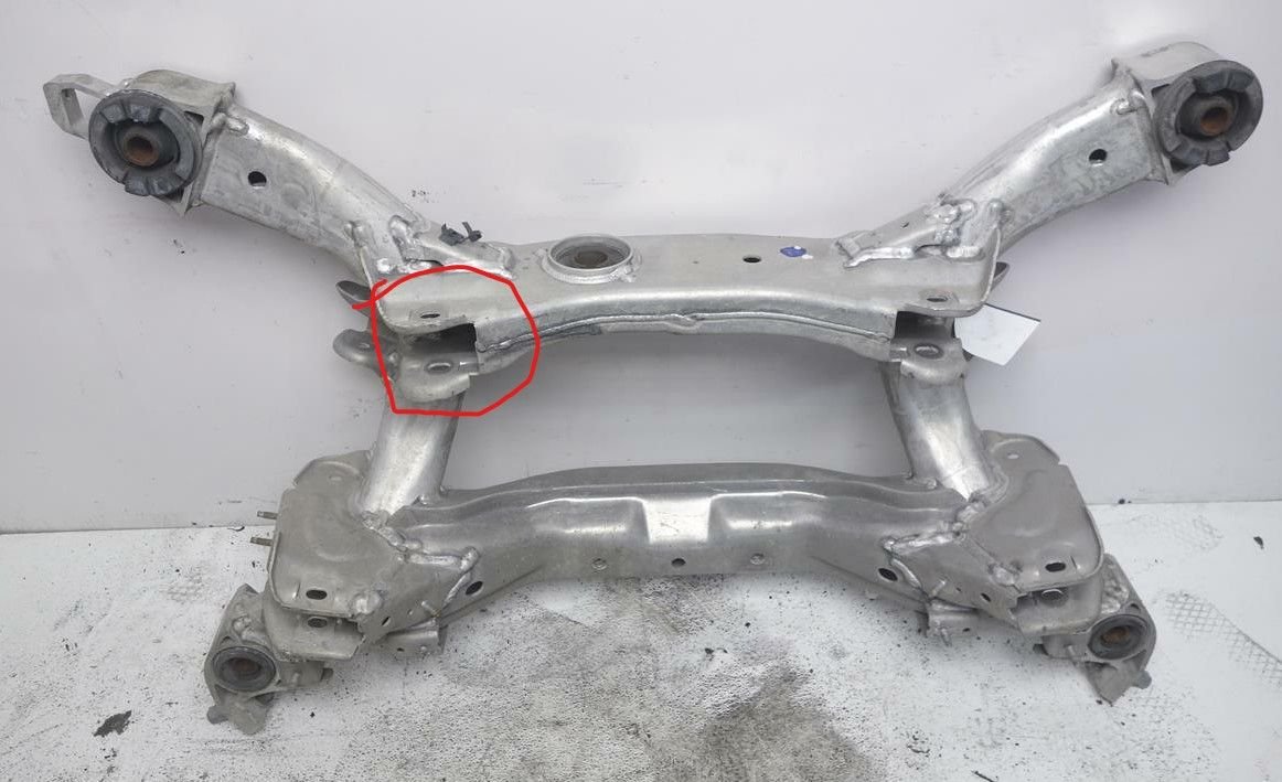

So you lost the lower spring bucket yeah? And the spring probably feel out yeah?
If so then it's likely the rear subframe that broke, really odd for it to break right there though since it doesn't really have a lot of pressure on that location. I've never seen one damaged like that before?
Was this car modded at all on the rear suspension or was it all stock?
If it is the subframe (looks like it broke right where the spring bucket attaches to the rear subframe, normally there is an eccentric bolt that goes through it and that's how you make alignment adjustments) then it's a pretty straightforward repair. Remove the exhaust, driveaxles, propeller shaft, rear differential, couple more bolts, then the whole thing drops straight down.
This looks like the part that broke, I circled in red exactly where it looks like the attachment point is ripped off. Not exactly sure how this would happen though I've seen some seriously wrecked Gs and 350Zs and never actually seen the subframe wrecked like that because the stock components that connect to it are almost always the weakest link and will bend/break long before it damages the subframe.
If this car was modded and had true coilovers then I could definitely see that breaking the subframe since those aftermarket turnbuckle rods that replace the lower spring bucket are super stout.
yea basically. the suspensions wasn’t really modded all it had was low springs. i hit a really bad pothole and this happened. i figured it would be the subframe. would i have to replace the whole thing for that small chip or is there a way to weld it and still be able to drive
oh and thank you for this information i jus realized how super accurate this was. the spring bucket is on the floor but i think the spring was lost as well. my friend was telling me we could prolly weld it but just in case that wouldn’t be a good idea how much would the labor for replacing the frame cost. ik the frame is like 500-600 retail so im tryna calculate rn

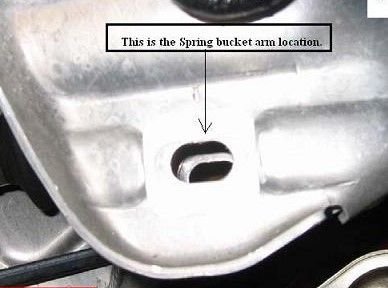

Here's a close up of what it looks like.
And here is the eccentric bolt that goes through it.
The washers on the bolt are captured in place on the subframe, when you rotate the bolt the center shaft moves back-forth to bring the spring bucket in or out to set vehicle alignment properly.
If I had to guess labor on the subframe replacement I'd say 6-7 hours, look up a couple videos on people doing a rear camber kit, that will highlight the suspension removal, then look up videos on people replacing the rear differential bushing, that will highlight the diff and axle removal.
The exhaust components come out quickly so that's not much of a time consumer. The rear subframe is VERY easy to remove, it's just got quite a few other components that need to be removed first, suspension, exhaust, differential (including axles and driveshaft).
You can also look up videos of people replacing the subframe bushings with polyurethane or solid bushings.
Fortunately all those components are commonly replaced items for performance parts so there's a LOT of videos out there on youtube of people taking those things apart, then you can decide if it's a project you want to tackle rather than paying a shop.
Welding on tabs from a donor would be cheaper and easier, but you need to find someone to weld aluminum at your house, or have the vehicle towed to a shop, plus you will need to salvage tabs off a donor.
