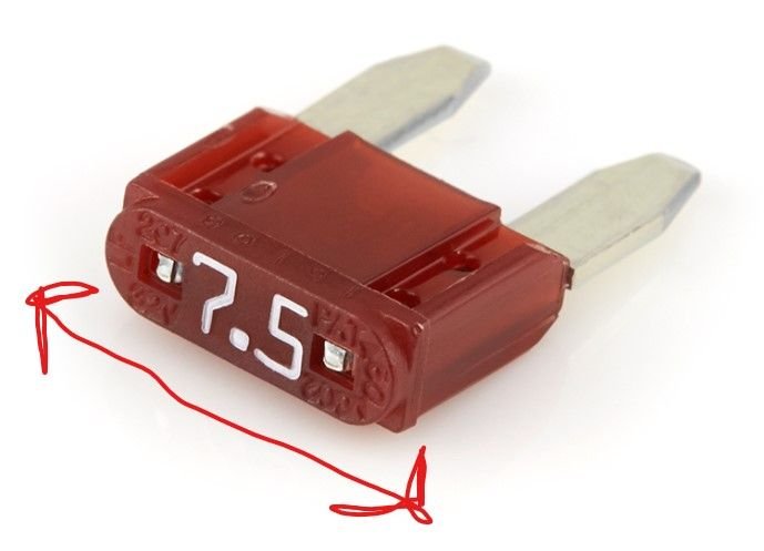

What are you using to pull the fuses out? I typically use a pair of needle nose pliers because who ever has an actual fuse puller handy.
Don't ever just pull the fuse straight out, wiggle it side to side this way as you are pulling.
Never wiggle it this way.
Personally I have never broken a blade off a good blade fuse, either a medium blade or a mini blade. I HAVE however broken the blade off one that had blown up crapastrophically. I use steel dental picks to remove the remnants of the old broken blade. I have one this shape that works GREAT for fitting into stuff like that.
