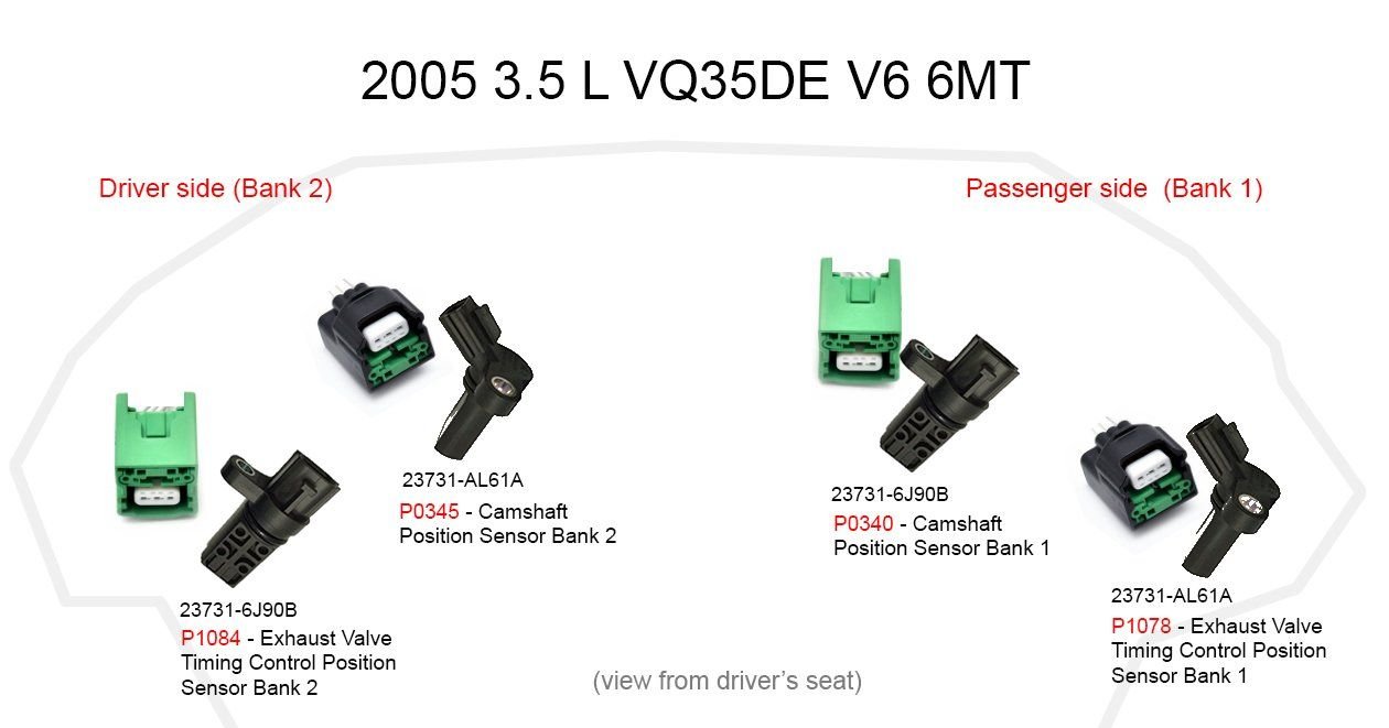

I would unplug both the exhaust magnet retarders on bank 1 and bank 2 and measure ohms across them to see if they are both the same. If the numbers are quite different then you might just need to replace the bank 2 magnet retarder.
I would also swap the bank2 exhaust cam sensor with the bank1 intake cam sensor since they are the exact same sensor, that will verify the cam sensor isn't the issue. If the car starts throwing a bank1 intake cam sensor code then you know that sensor is faulty.
Personally I would replace the crank sensor you swapped with an aftermarket just because they are HIGHLY notorious for causing issues with these engines, OEM Nissan or Hitachi only for all your engine sensors. If your problems existed with the previous sensor then I doubt it will fix this issue but at least it will help prevent further issues in the future.
Here is the layout of the cam sensors from the rear of the engine.

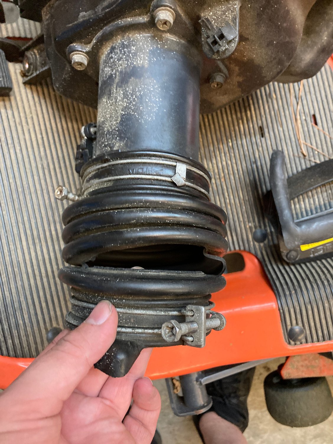

Just picked up new plugs and a hitachi driver side bank 2 camshaft sensor. Putting all of that on right now. Also found my intake leak check this out lol
So here’s a little update, I installed new NGK Iridium spark plugs, and the new hitachi camshaft position sensor, the old camshaft position sensor bolt was hand tight, also was covered in silicone like someone tried to seal it, so I cleaned the hole and around it and peeled off the silicone, then installed the new cam sensor with oil on O-ring.
I know this is ghetto but I ducktaped the hell out of the boot that was torn and added zip ties to the missing areas where there were clamps.
I have now just got back from an almost 40 mile drive and the car is running great! Check engine light is off and It is idling and running smoother than ever, it seems like it picked up all the responsiveness it lacked before and the power it has now, left me smiling the whole ride. Didn’t beat on it hard at all but I can’t wait to see what it can do another time.
I will continue to keep you updated on the status of the car and if the light comes back, thanks for all your help!

For the future, electrical tape works better than duct tape for temporary bandaid fixes on those flex sections. Pick up another one at a local pick-n-pull salvage yard.
