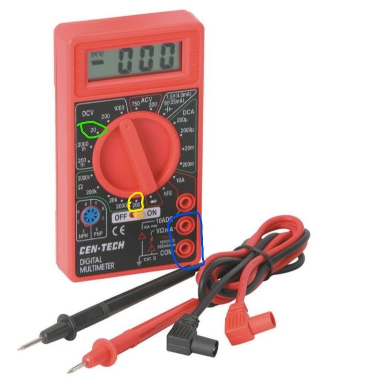

The coupe doesn't have the trunk wire harness issue, that's a sedan problem. Coupe doesn't have lights in the trunk lid like the sedan does.
However it still could have a broken wire due to other reasons. I still suspect you're not actually checking the brake light switch, here's a picture, it's the upper one.
And you still do need to use a digital multimeter to actually test for power, a test light would work for the brake pedal harness too but to test continuity to ground at the taillight you would need a DMM.
The cheapo Cen-tech from Harbor Freight will work find for this kind of stuff, I think it costs less than $10 still. Just set the dial on DC volts 20v range.
Here's a picture, the leads plug into the ports I circles in BLUE, your red lead goes into the top one and that's the lead you test for power with, the black lead you touch to something that's chassis metal/ground. Any unpainted surface will work like a nut or bolt.
For voltage test turn the dial to the GREEN circle, then put the black lead on chassis ground, the red lead tests for power.
To check resistance (ohms) for ground turn the dial to the YELLOW circle, watch the display as you touch the leads together, it will show either 1 or 0 (continuous circuit), put either lead to chassis ground and the other lead onto the pin4 (black wire) of the tail light harness and the meter should show that same 1 or 0 continuous circuit reading.

my g35 is a coupe model for the record. we are definitely checking the brake switch not the cruise control btw dont worry. the brake lights do turn on so its something before the brake switch. im gonna go see if i can get this dmm today

Ok cool, definitely start with testing the brake switch though, that's the middle point of the circuit so you can determine which direction to keep troubleshooting.
Here's the line direction of power for the circuit it's either going to be
-Bad fuse, no power going to the brake switch
-Good fuse but no power at the brake switch = bad wiring between fuse and switch
-Power going into the switch but not coming out of the other side of the switch = bad switch
-Power leaving the switch but not getting to the brake light = bad wiring between brake switch and brake light
-Power coming into the brake light but the light isn't turning on = bad ground at the brake light.
I'm leaning towards it not being a bad tail light ground since all 3 of the brake lights don't work.
