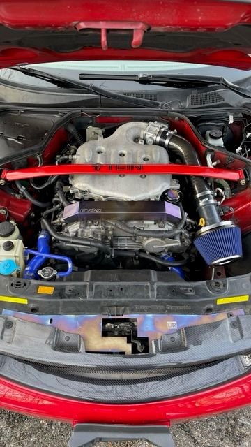

I'm getting about 170 to 180 miles per tank, I don't beat the car and I only drive 15 miles per day to work, 7 each way.
03, Coupe, 114K, Borla true duel exhaust, Z1 high flow intake, spacer, Cobb stage 2+ tune with a perfect 14.7 AFR. The Cobb tune wasn't my choice!
No faults, MAF is clean, just installed the intake, but my old ARC filter wasn't horribly dirty. Throttle body was replaced and looks clean. The car drivers smooth and pulls hard, no misfires or hesitation.
Just replaced the spark plugs to one step colder, the old ones didn't look that bad at all. They were not fouled out at all. I do smell raw gas coming out the exhaust on start up.
I haven't had the chance to remove any 02 sensors to check condition and I don't have an advanced diag tool to watch 02 signals yet.
Saving for an Z1 UpRev tune. I threw in a can of Royal Purple Max Clean with my last fill up, I only run 91.
Any ideas? I know it'll be just a guess, this is all the info I have to work with myself. Maybe it's the tune? Oil doesn't smell like gas and I don't smell gas leaking anywhere.
I did see an old thread were the someone ran seafoam through the intake, I'm wondering if I should do the same. Any thoughts are welcomed, thanks

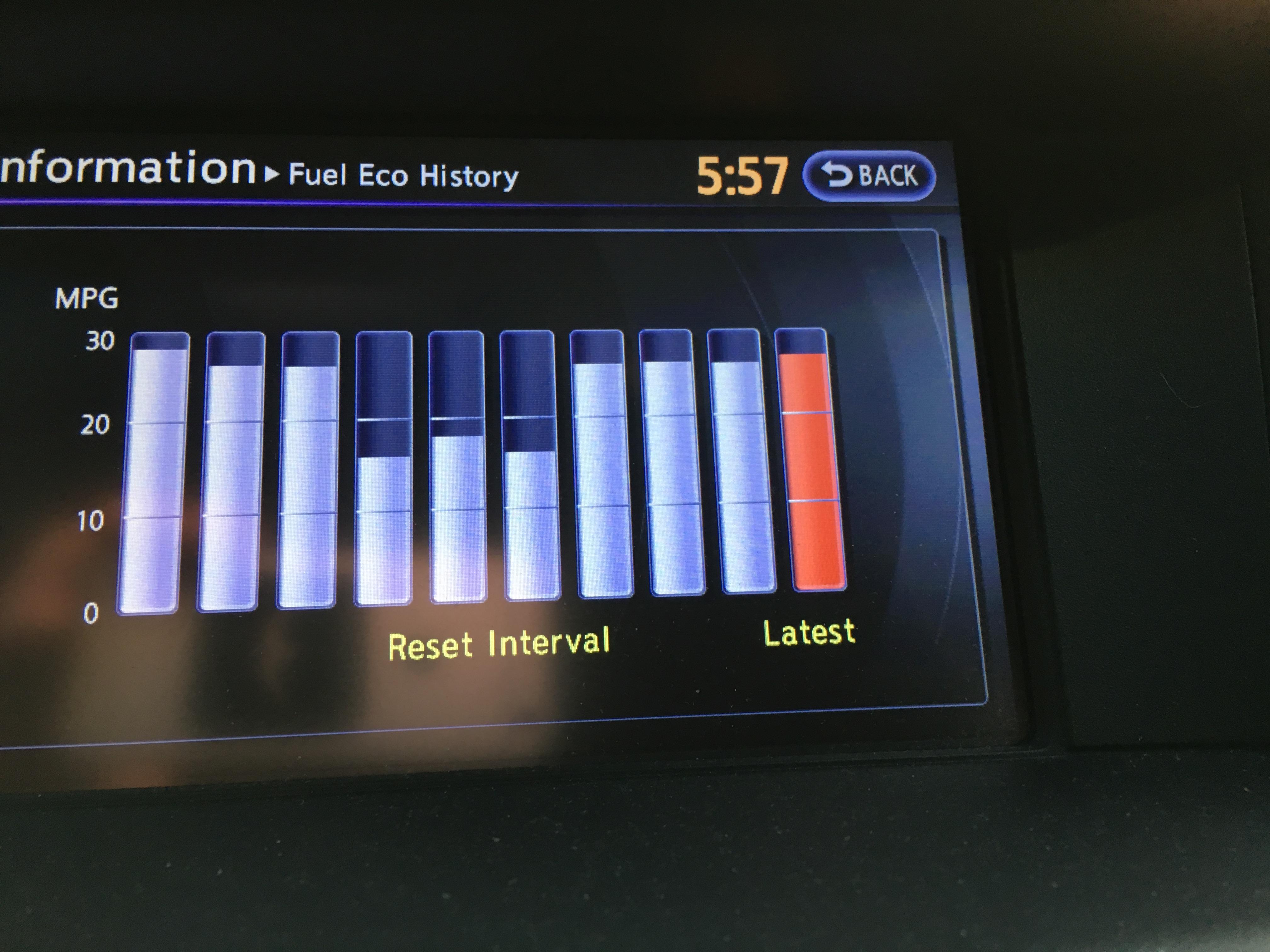

I'm on my third Infiniti since December 2005 and on every one of them I got poor MPG on short trips local driving and excellent MPG on long trips from NJ To Florida many times exceeding 27MPG on a single tank of gas of over 300 miles. I have never used anything other than 87 octane in the over quarter million miles that I have driven on my three Infiniti's
You can see the results of the short trips while in Florida compared to the results on I95
I would suggest that you fill up your tank,, drive 300 miles without stopping, fill up again and divide the gallons to fill up into the total miles traveled.
I'm sure you will be surprised at the result.
