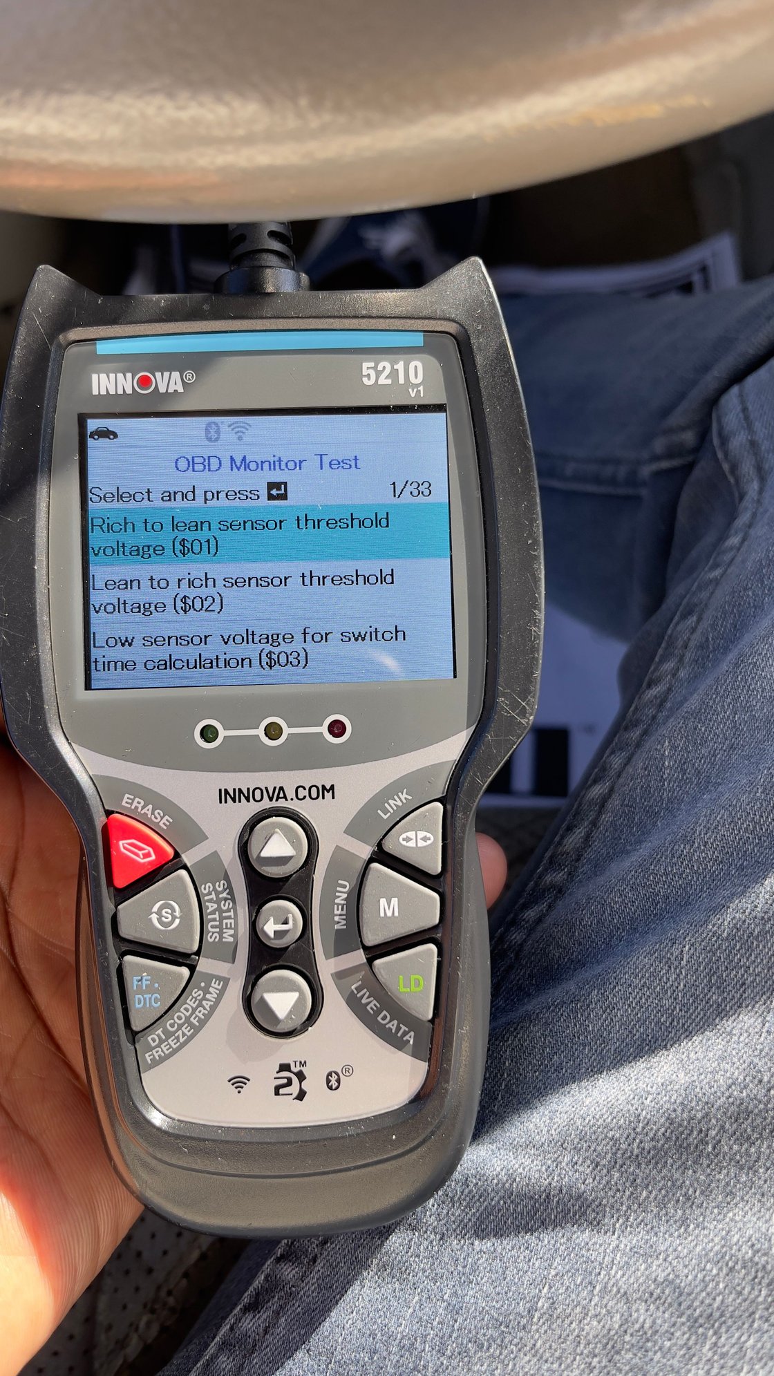

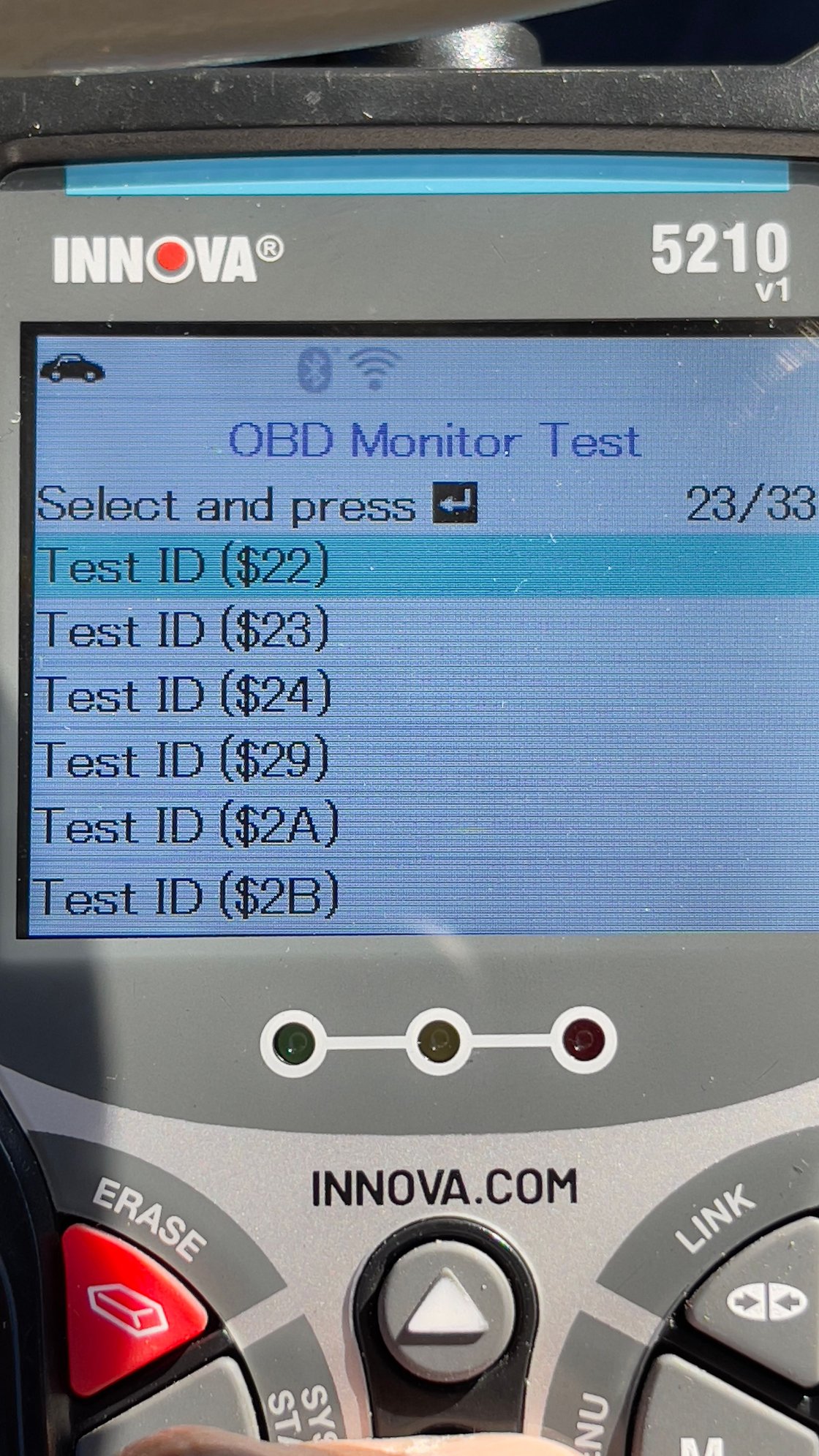

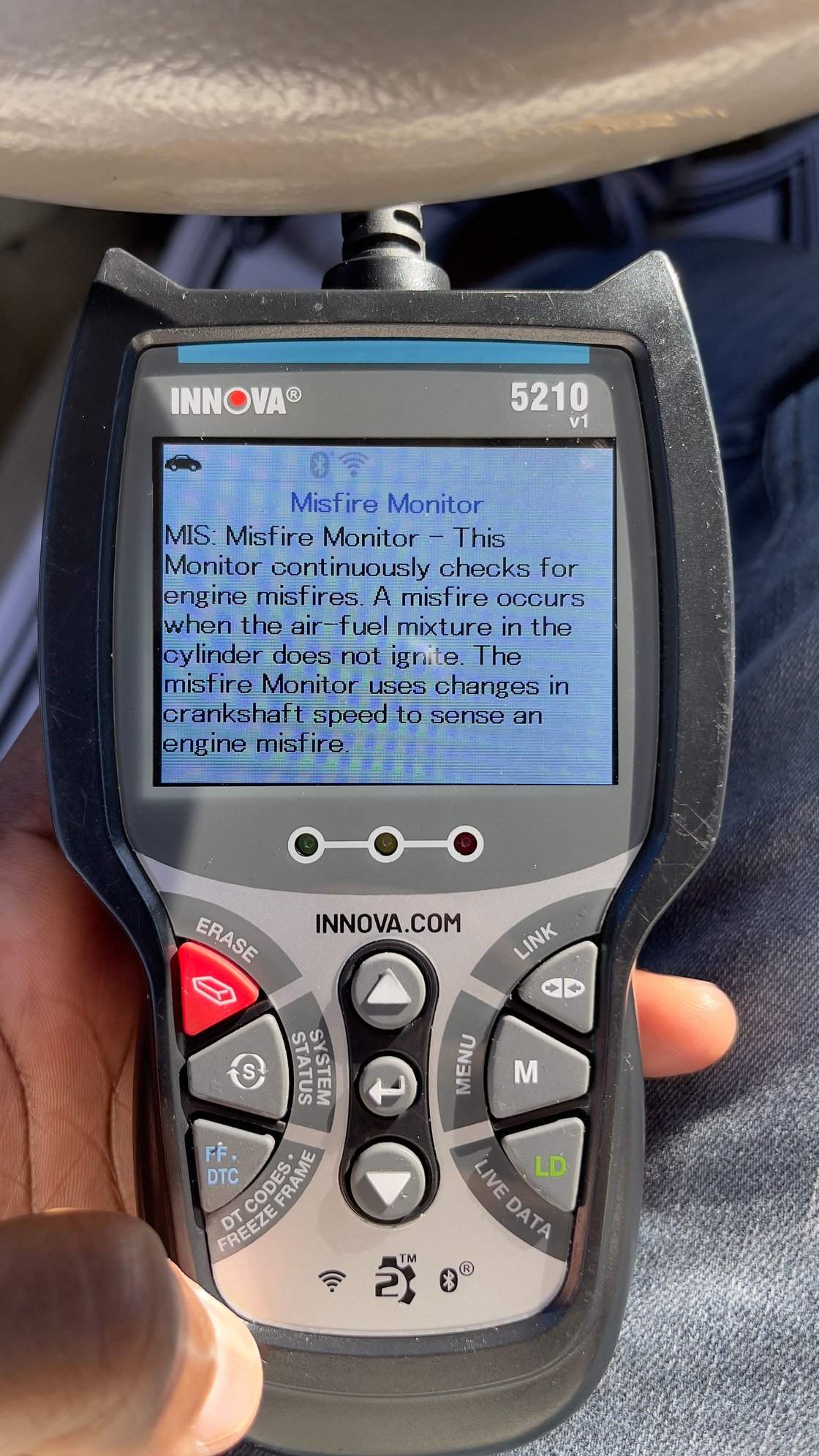

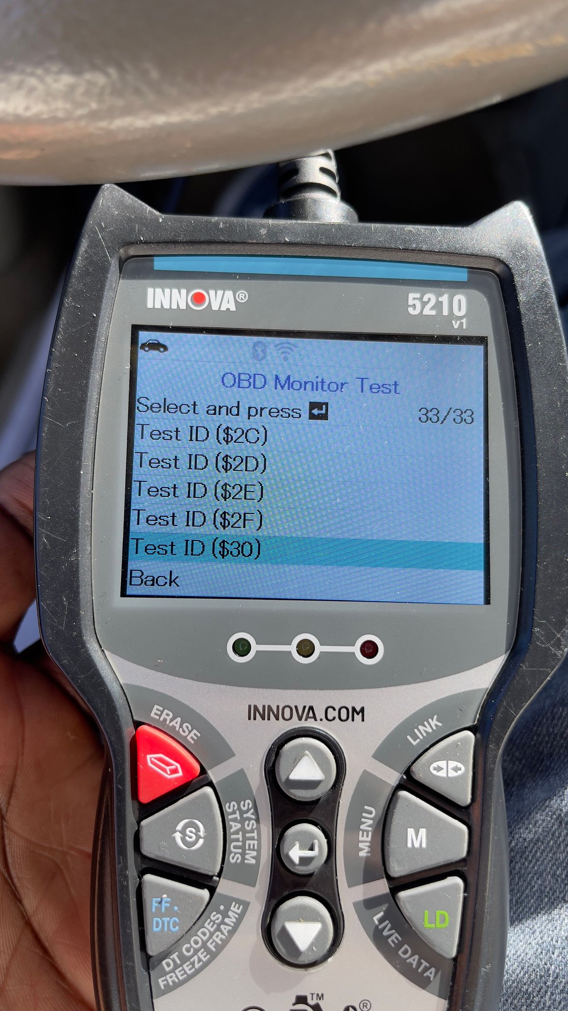

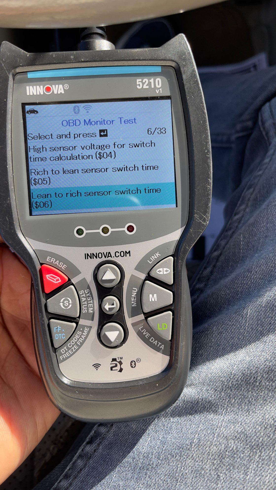

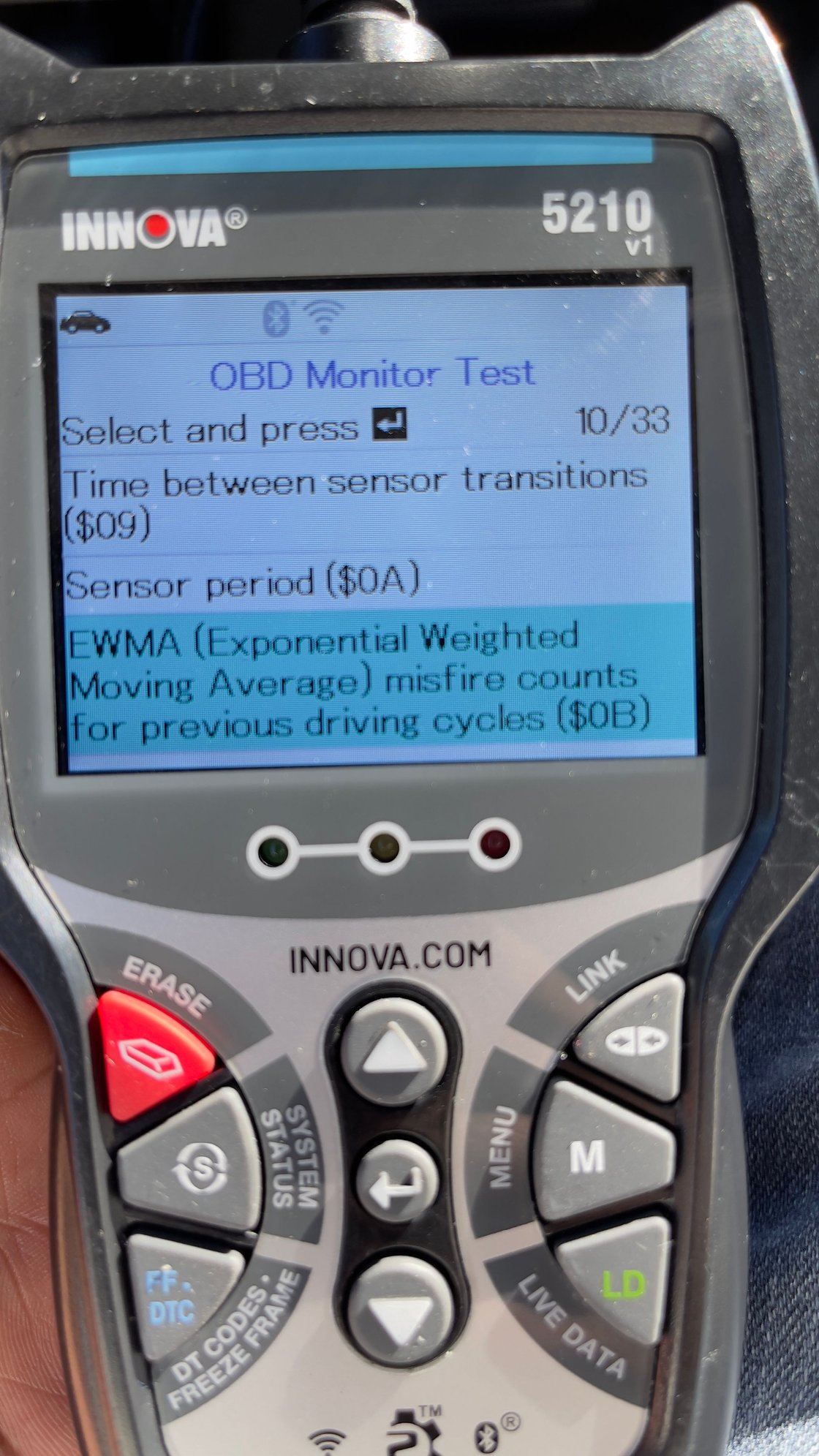

Feb 1, 2022 | 06:55 PM
ok, did an OBD scan at Advanced, this scan looks a bit different from the ones I usually do and so does the machine, but hopefully this will help. I'll try to go to another shop to get a scan from another machine to see if I can get a more straightforward scan with actual codes, but let me know if any of these make sense.
Reply 0
Feb 2, 2022 | 09:10 PM
Normally from the main screen is a "retrieve OBD2 codes" option, somehow you navigated into all the individual PID functions of that scanner.
