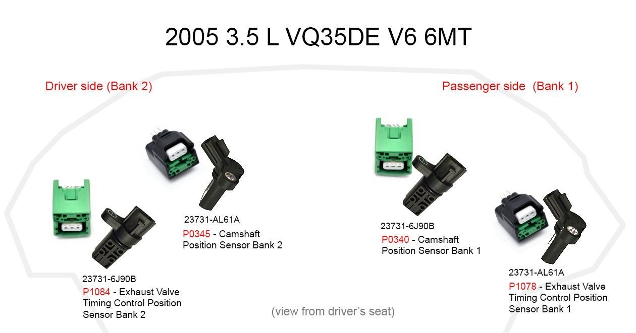

Keep in mind there are 4 cam sensors on your car, are you SURE you replaced the correct one? Typically on a rev-up you just swap the intake sensor with the exhaust sensor of the opposite bank since they're the same. Then see if the code follows over to where you moved that sensor.
yes - i replaced bank1 (passenger side)

Swap it to the exhaust side on the opposite bank and see if the code turns into P1084, then you will know for sure the sensor is bad. If the code persists then something else is going on and it's time to ring out the wiring harness back to the ECM and look for an open/shorted/damaged wire.
