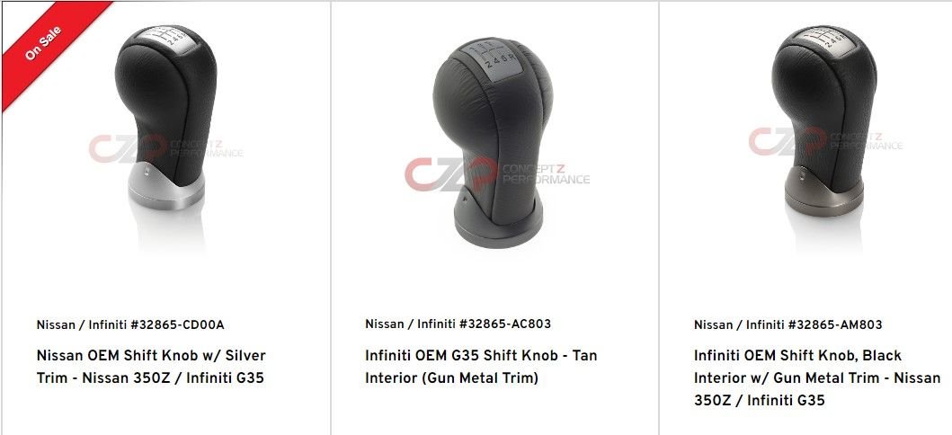

What replaced 32865-AM803 shift **** for the G35 6MT?
Hello all, my shift **** is worn out and would like to replace it for a OEM part, not an aftermarket ****. The part for the G35 2004 is 32865-AM803 but it seems that part is discontinued, I know there are some available for $240-300+. I was wondering if any of the Nissan *****(350z)with similar specs like the 32865-CD70A or the 32865-CD00A would fit. I called the Infiniti parts and they can't say if they do, pretty much they said the only way is to buy it and try it.
I was wondering if anyone had done this before.

32865-AM812 according to Z1, but they're still $265. Circle Infiniti used to have these available on their eBay store for a reasonable price and I always told myself that one day I would pick one up. Now they don't have them. Luckily mine is still quite decent.
Edit: Looks like the AM812 part is the "sage" color for tan/willow interiors. Here's what CZP shows for the other part numbers. It appears they are all interchangeable.
