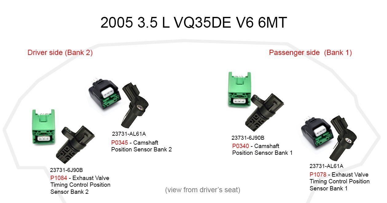

Codes
So the codes areP0345
Camshaft Position Sensor "À" Circuit Bank 2
P0171
System Too Lean Bank 1
P0171
Now you and all of us know the problem.
And we know the solution 😏
Replace the cps

Use only OEM or Hitachi (OEM mfr) sensors. Lots of evidence throughout the forum that cheap aftermarket sensors either don't work or don't last. Don't be that guy!

Ignore that bank lean code for now, it might have been caused by the engine stalling. Replace the CPS, clear codes, rescan for codes and see if it comes back.

i replaced the camshaft sensor bank 2, and ecu reset, but the problem is still there it stalls and turns off in low rpms
and the code is still there p0345

Just to verify, you replaced the one on the DRIVER SIDE correct?
If so, did you use a Genuine OEM Nissan or Hitachi sensor?

No I ordered them from amazon and both cam shaft and crankshaft, when i cleared the codes the codes didn’t come for 1 month but the problem was still there, today service engine light has turned on again and problem is still the same

It's a pretty common issue for all aftermarket sensors to fail quickly, or to just not work at all.
Strongly suggest either Hitachi (the OEM manufacturer) or a genuine Nissan sensor.

Yup, aftermarket sensors dont work well with these cars. I have tried it too and found out the hard way.
Buy an original Nissan sensor or a Hitachi. And dont buy the ones on ebay that say “OEM”. Theyre usually around $50 bucks and even come with Nissan packaging but they are FAKE!!
