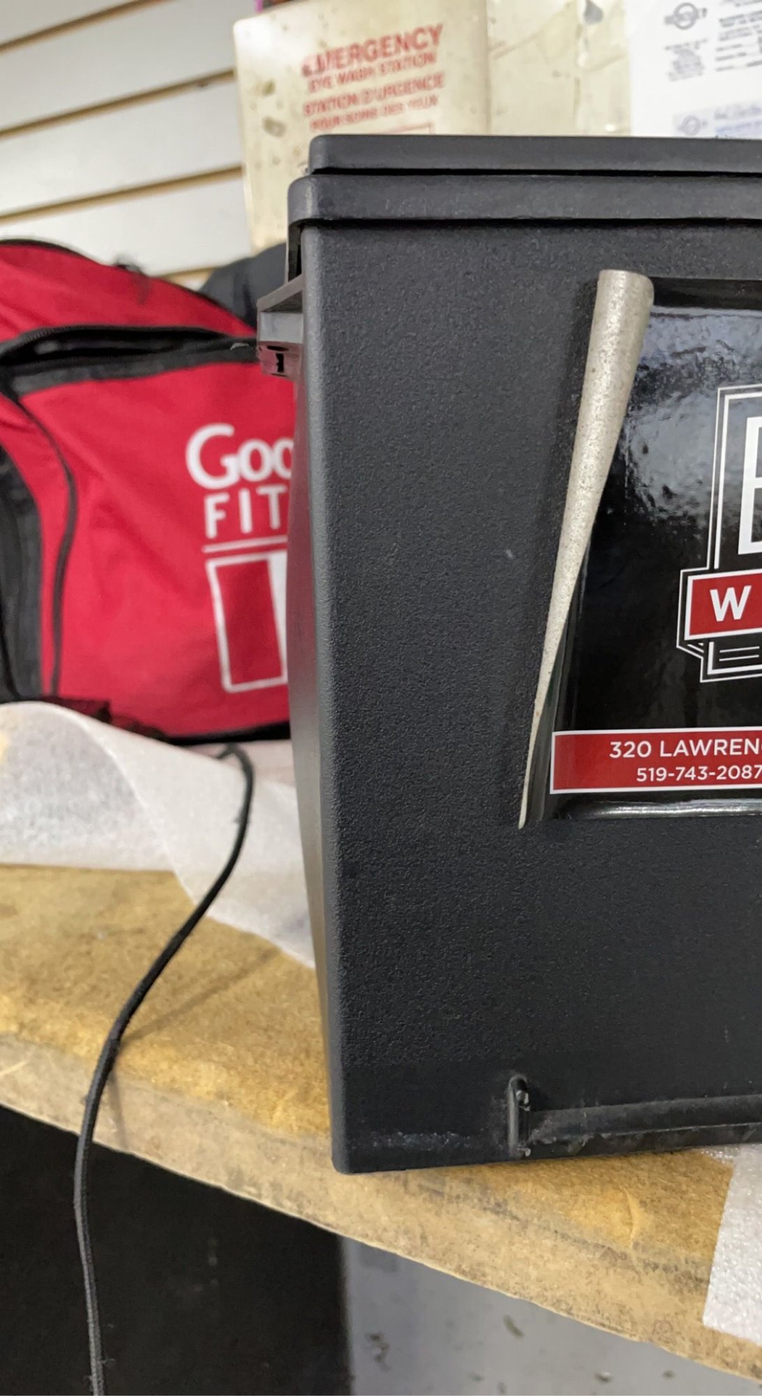

Alright I installed my ipdm after replacing with new fuses but kept old relays and my lights turn off again and thankfully they’ve been working properly. The only odd thing that happened was that when i disconnect battery (specifically negative terminal) my headlights started flickering really fast. I did swap my battery because when I was charging it, I happened to over charged it and the battery was slightly swollen. Now my car seems to be running well.

I think you compromised the battery, wouldn't surprise me if it's actually reading at or just under 11 volts with the car turned off. Double check that the voltage is correct (12.5 or so), it's caused by gas buildup (from boiling the electrolytic solution) and hopefully the plates didn't relocate inside the housing. Normally you will have a relocated plate that ends up shorting out one cell on a bulged battery.
The battery is 6 separate 2volt cells, each cell has two polarity of plates separated by a spacer/separator plates. Filled with distilled water (or some solution, it becomes H2SO), and when you have a bulge it's pushing all the polarity and separators together which usually causes a short once it cracks those separator plates.
If you look on the side of the battery you will see imprinted lines running from top to bottom on the long side of the battery, those are the cell dividers, you can count the six cells.

Oh yeah I didn’t reuse the battery because I didn’t want to risk anything.
