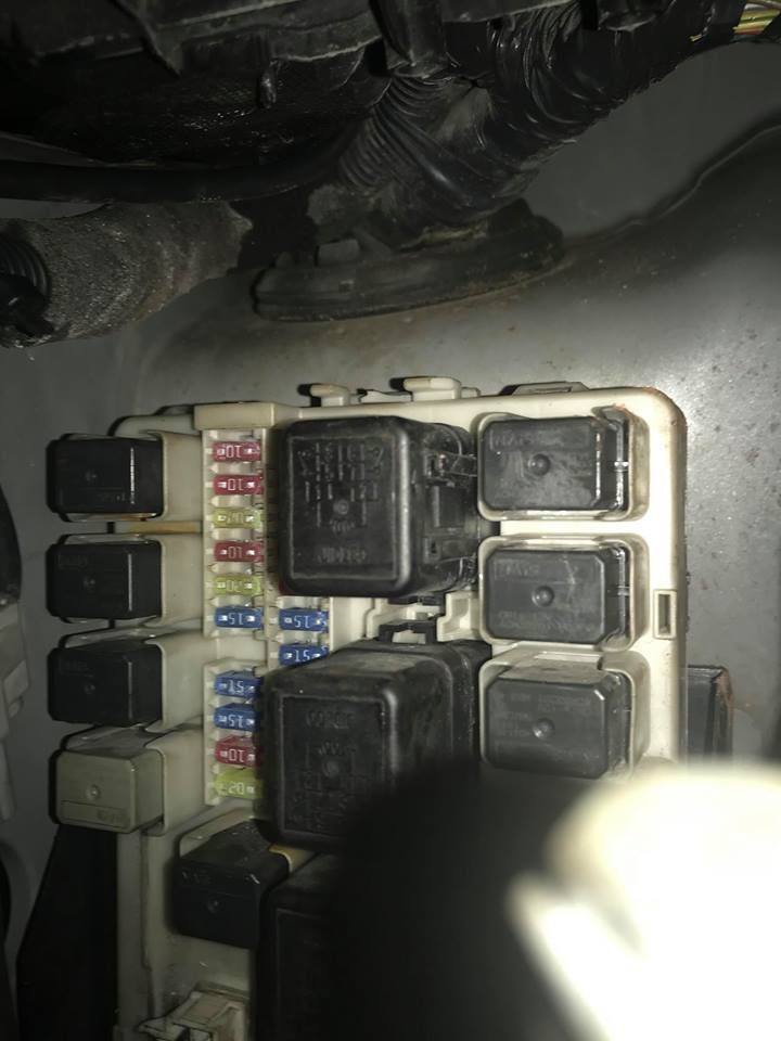

Uhh ohh, take a picture of the fuse box, preferrably with the "green liquid" and post it. I have a feeling the insides have become contaminated with moisture and have corroded to the point that the copper is practically melted away (copper turns green when it "rusts").

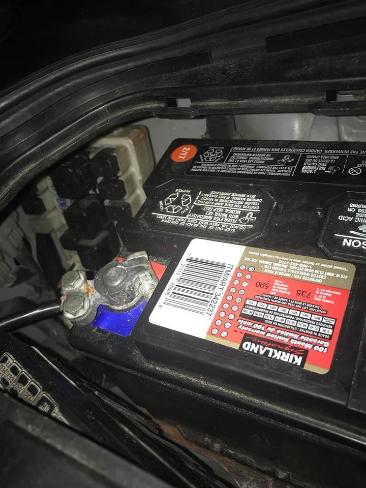

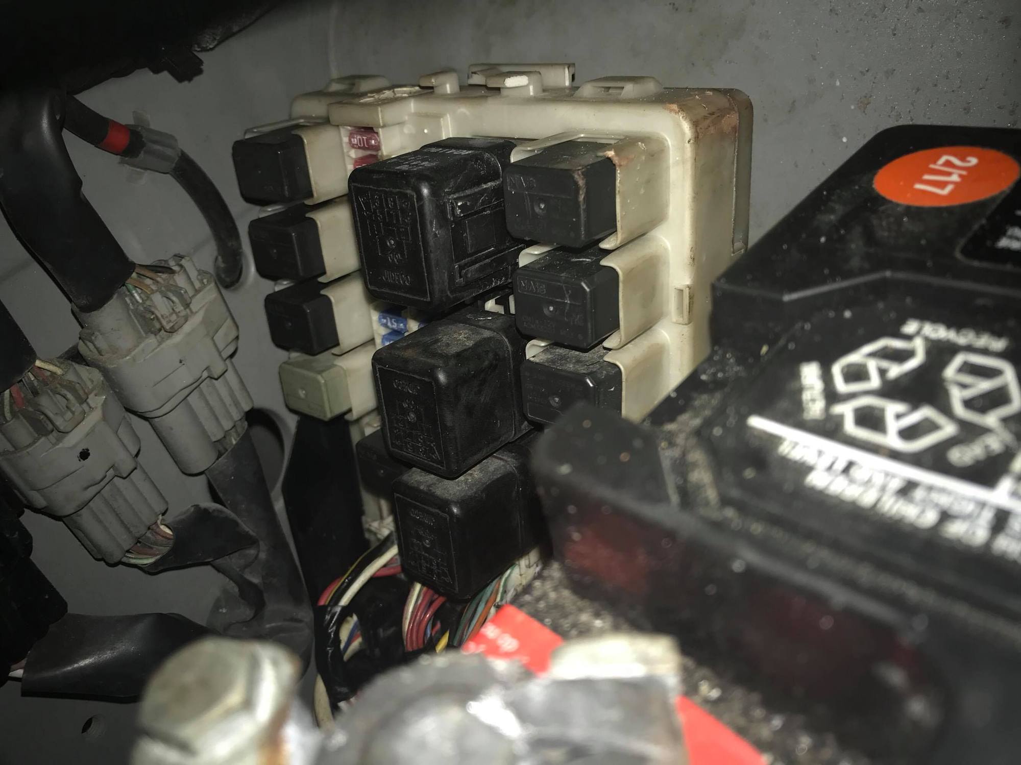

So I just took some pictures and it all seems clean from the exterior since I got it cleaned yesterday. You can still see a little bit of strange coloration but it was 5x worse yesterday. Like I said, I do not have the cover to protect it from most of the water.
Just to show how vulnerable it is to water. Ignore the crap battery it's not the problem.
Do you know the part number for the IPDM because it seems like there is more than one possible...
