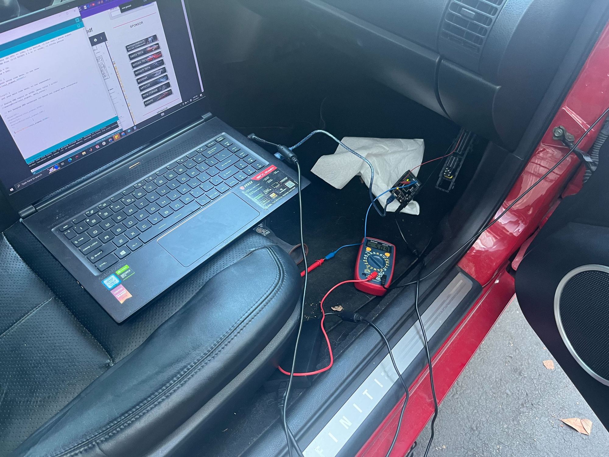

I ran some more tests today.
I hooked up an Arduino to the ECM harness connector to simulate signals that the ECM may be providing to the coil packs. Basically, it just confirms if the wiring is providing the correct voltages and not shorting out anywhere. (See Pics Below)
For the most part, the signals checked out...
I can very confidently say that I do not think there are any obvious shorts and/or conductivity issues.
I sent both constant voltage signals (5V) and PWM signals to coil packs 1,3, & 5 and saw that the measured voltages from the connectors were more or less the same.
I tugged on the wires pretty decently for coilpack 3 and did not see anything change.
The signal for coilpack 3 was also never shorted to ground during the tests.
This suggests ECM issues, assuming everything checked out as I said...
However, what I did notice was that sometimes, the signal for coilpack 3 would fluctuate between 0.00-0.03V lower than the other two coils. This is not a very significant difference, however I believe this signal for the coil pack is pretty sensitive to changes in nominal voltage. In fact, when starting the car after I could see that the live signal for coilpack 3 was between 0.17-0.20V (so not a dead misfire after ECM reset, like usual) which is precisely 0.00-0.03V below the expected nominal voltage of 0.2V that I measure on the other coils.
By the time I had conducted my test, it was already starting to cool off in the afternoon and I have noted that high temperatures seem to make the car run worse with misfires appearing much quicker and seeing the voltage of coilpack 3 go down to 0.00V at times. So, I think I would like to run this test once more at high noon when it is very hot just to be super sure that the heat isn't affecting the harness in such a way to knock down that voltage. I am not quite sure how it would do this if it is not being shorted out besides the potential of bad contacts or bad ground (but I would also assume a bad ground to affect more than just one coilpack...)
If the heat is not making significant influence on the measured simulated signal, I think I can finally for sure say that this issue resides 100% in the ECM. However, if the measured signal drops even further, I will be replacing the wire in the harness to see if it can take care of the issue.
