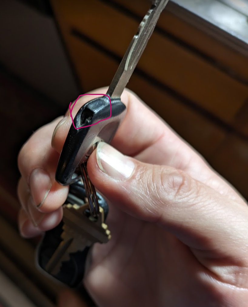

So you're using a different KEY yes? There is a RFID transponder in your key that is read by the BCM when you are cranking the ignition you need to use the key that the car was programmed to be using. You can dig the chip out of your old key and put it into the new one. Here's a few pictures of my key, I had to do the same thing. Helps if you use some flush cut pliers and cut away the side of the key just slightly so you can access the groove in the side of the RFID chip holder like I did, it's still held in with detents, then you use a small flat blade screwdriver in that groove to wiggle the holder up out of the key.
