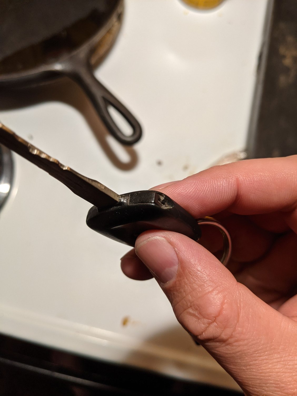

I dug the chip out of my key and put it in a new one when I landed on my keys a year ago and broke it in half. If you take a little time you can get it out without snapping the plastic like I did.
