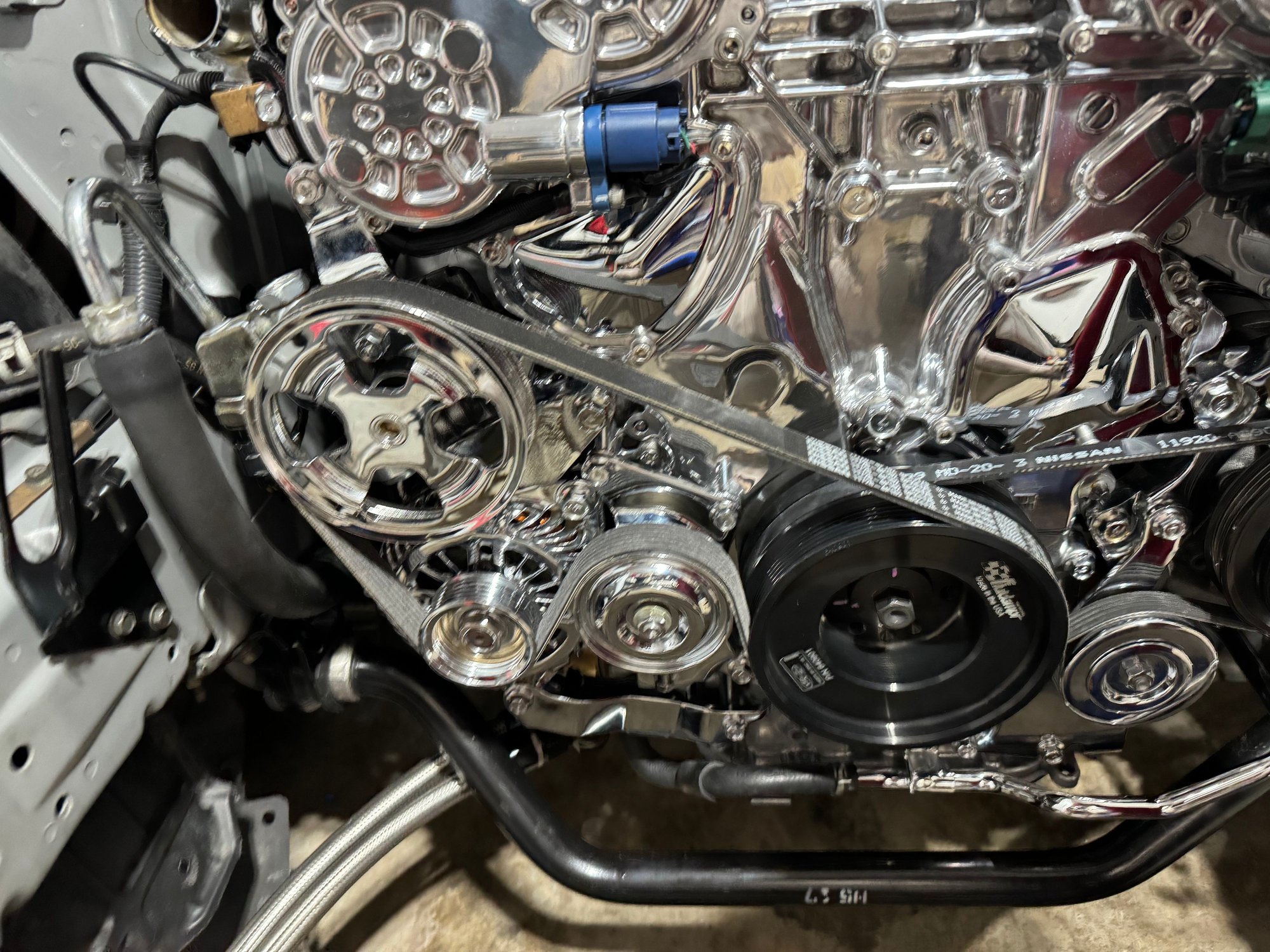

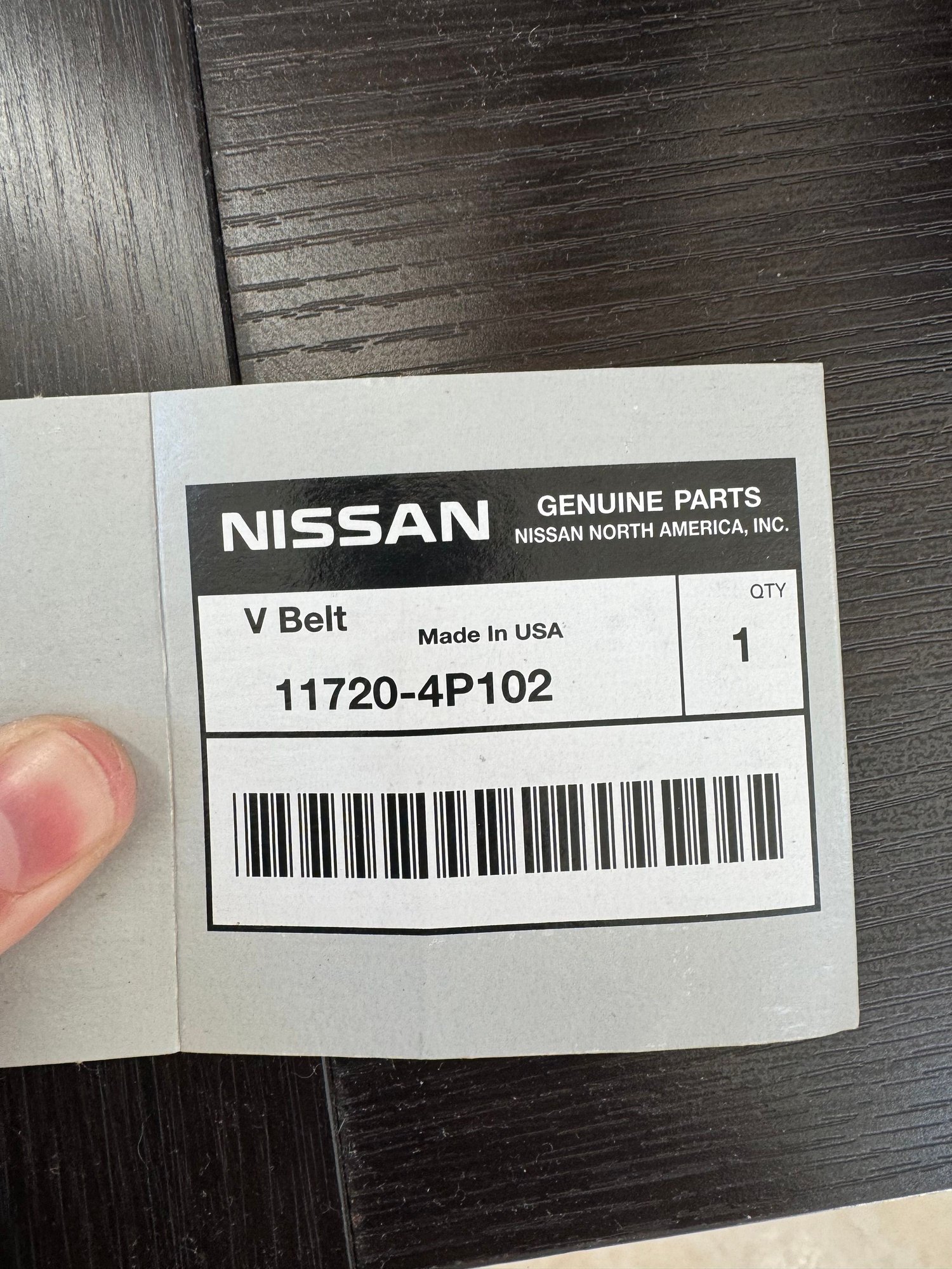

PSA For Fluidampr + idler pulley delete
Hello guys just wanna put this out there, that if you were pairing the Fluidamper crank pulley/harmonic balancer. You will still need to use the OEM long belt if you delete the idler pulley. I purchased the idler pulley delete kit off of Zan motorsports, and provided was too small.
