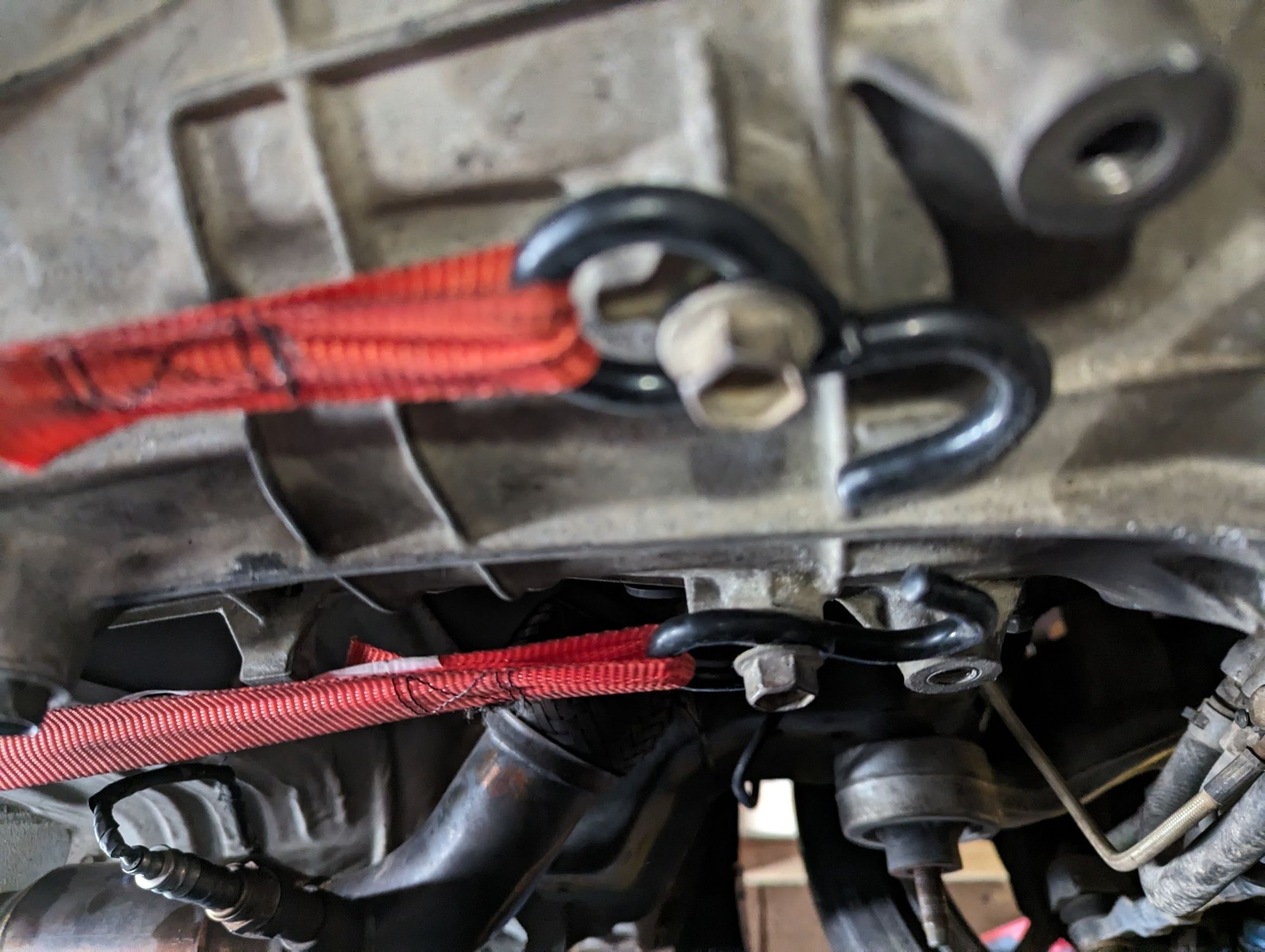

I'm about to throw in the towel on this clutch project and take it to a shop. I put ratchet straps on the rear "W" brace and tied that back to the bottom of the transmission with some bolts and it is still not moving at all. There has to be a bigger issue.
I removed my front brace, the one right under the engine, tried to pry at the 6 o'clock position,chipped a little piece off the upper oil pan. Close to where the 10mm bolt goes. Tried wiggling it a bunch and it still isn't coming off. I'm suspecting something along the lines of my clutch teeth not letting go of the input shaft. I don't think I want to risk breaking anything else so I'm going to put her back together.

I bolted the ratchet straps to the bottom of the bell housing
Connected it to the W brace in the rear and rachet evenly.

I figured it out, it was just really stuck. It seems like my clutch had chipped splines chips so that's where I was probably hung up on. I'll post some pictures soon of how I got it "unstuck" and freed it. Never changed one before so that was fun 😵
